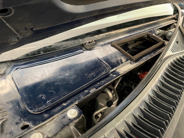

I had water fry out my blower motor, after heavy snow melted down into the duct. I also had water soaking the passenger footwell carpet. I pulled the plastic cowl at the wiper arms. It ended up being cracked sealant around a blanking cover, under the plastic cowl. The cover is directly above the blower motor duct. I resealed with silicone around the cover, and it fixed the leak. Cover is on the left in the picture.
