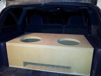

I ran 2 15'' Lvl 4's in 8 cubes at 36hz with 112 sq inches of port. It is the perfect width and not too tall. It sits right at the top of the back panels. I have a pic and dimensions if you wanna run it haha makes it easy on ya...

lol thats awesome! that will work perfect. where did you put your battery, and how loud was it??

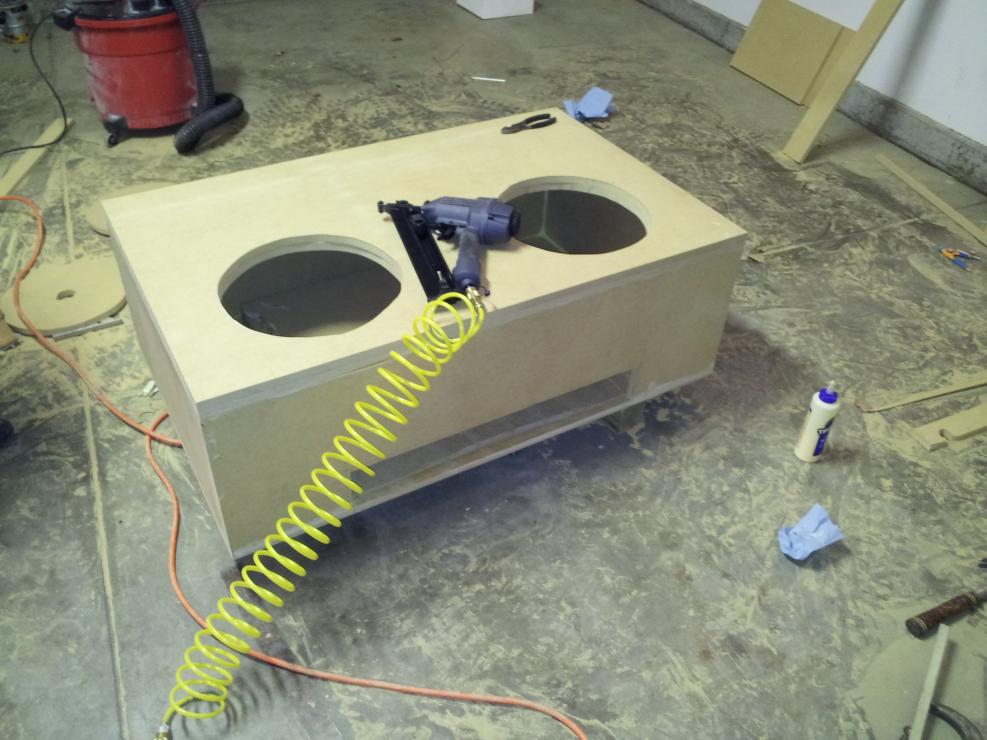

thanks guys.. im going to get started on it this weekend.. i think i might make the port just a little bit smaller.. how would i tune it to 34 hz? i still need to fig out where im going to put the battery
---------- Post added at 08:07 PM ---------- Previous post was at 08:00 PM ----------
also, i have barn doors so i was thinking maybe splittin the port into 2 ports and put them on the edge of the front instead of flat on the bottom of the front..

I had the batteries between the back of the box and the rear seats. Yea it was loud and sounded good. I had em on 3000 rms. That box tuned to 36hz had a pretty good range.

also in the dimensions how long is the port inside the box?
Lemme look that up.
