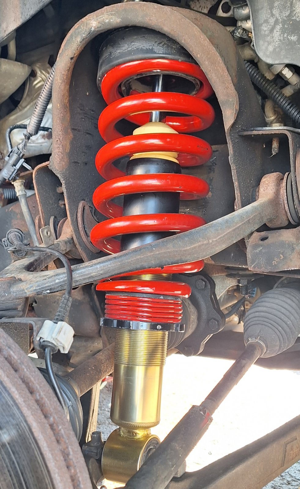

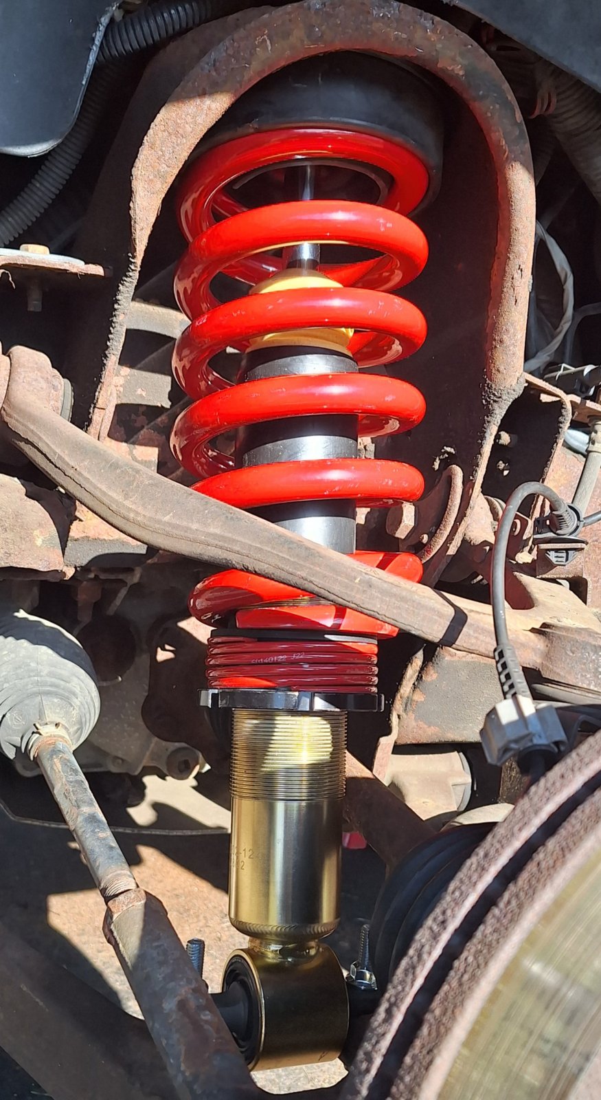

Yeah, I just bit the bullet. I dropped the coin on some Belltech coilovers. I'm going to leave the spindles in place for now and use the coilovers to get the nose down to where I'm happy with it.
Thanks for your assistance

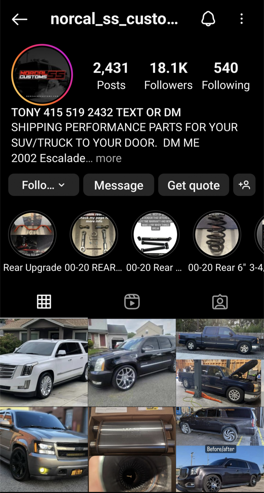

I use front drop struts. Sell em for 275 shipped
Nice. I'm interested to hear how they ride and handle in comparison to your PPV components.
BTW, save those springs- front and rear. If you'll never raise yours back up, you can sell 'em to recoup some of that coilover cost to someone wanting a mild drop.
