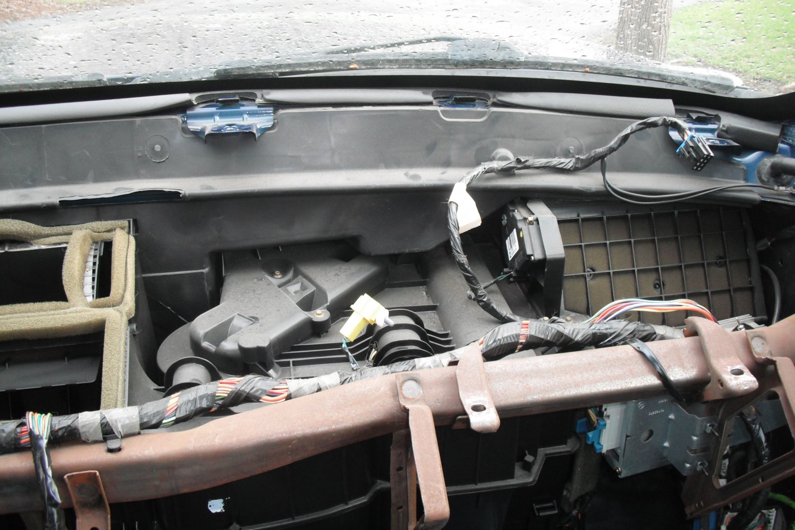

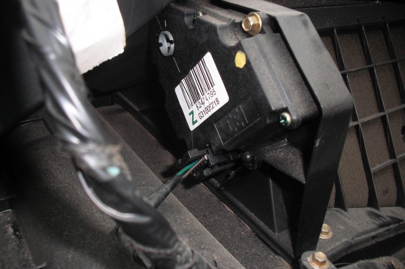

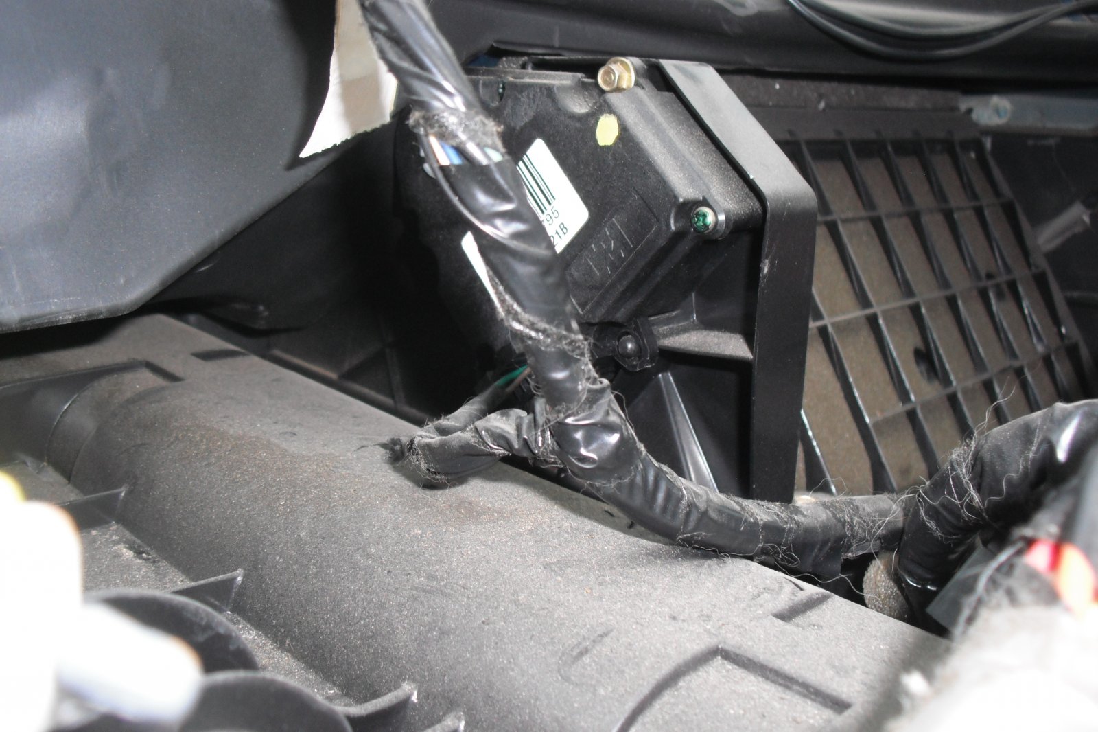

Wow, that helps a lot, thank you for providing this! This is going to require some serious study but the pictures will be invaluable! Thanks again for taking the time to take and post these!!
Not sure how you got your dash cover off but I had to watch a few video's because it was really stuck on there.

UPDATE - I FIXED IT!!!! It wasn't pretty or simple but thanks to JonnyTahoe's pictures, its done and working! I've been a technician all my life and have had to put things in a lot of places others said was impossible so I've never been afraid to rip stuff up, and thats kinda what I did what I did.
After some significant and very serious language, I could not figure out how to get to it from below. I finally decided the Hell with it, and got out the vibra-saw. Once I removed the u-shaped metal bracket, I sawed the black tube in half. That gave me enough room to get into the 2 screws. FWIW, my Tahoe only had 2 screws so that was a lucky break. Getting the old one out wasn't simple but it came out. Putting the new one back in required a lot of the aforementioned language, but back it went. A little duct tape and reassembly, and another actuator replaced!
Thanks again to Jonnytahoe and everyone else who offered ideas and encouragement! This place is the best!
