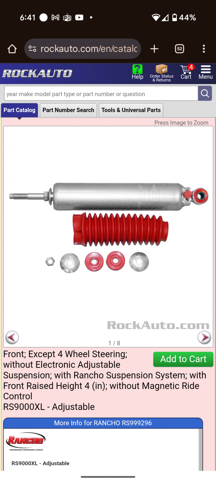

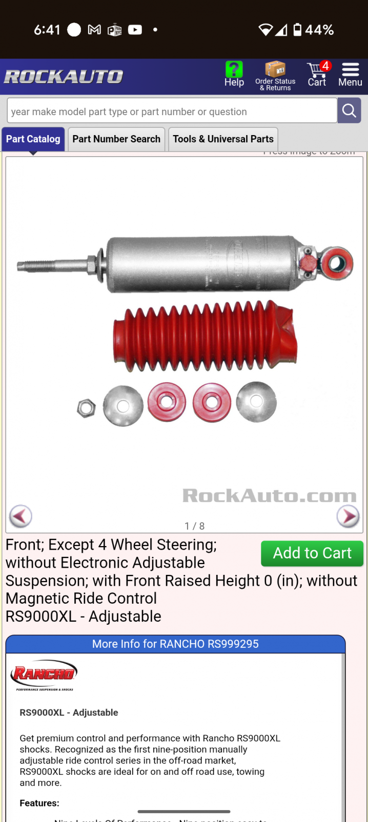

What you guys think about these BILSTEIN 24185783.
My autoride is disabled long time ago. My trunk is SLT 4x4 . What you think will these be good alternatives. And should I lift a truck to install them?

I did Rancho 9000xl, the adjustable ones. I have liked them so far.

Rockauto says that they are not for 4x4
Odd…? If the same Bilstein part number is used for the 2x4 as the 4x4 then the Ranchos should work as well. Either way, both shocks are good. Been following your work! Great truck and keep at it!
On the GMT800 1500 pickup trucks, the 2wd use coil springs vs torsion bar for the 4x4, so the control arms and shocks are different.
I forget if all GMT800 1500 SUVs were torsion bars? 03-07 for sure. Or did they use coil springs on the earlier 2wd ones? I honestly don't know, but maybe that's why?
Just went and looked up a random 2000 2WD Tahoe. Lo and behold, 15051907 & 15051908 front torsion bars.
Did not know that the 2WD GMT800 pickups used front coils instead of torsion bars. Interesting ...
