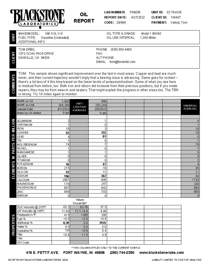

Here is the old one prior to cylinder head replacement..
