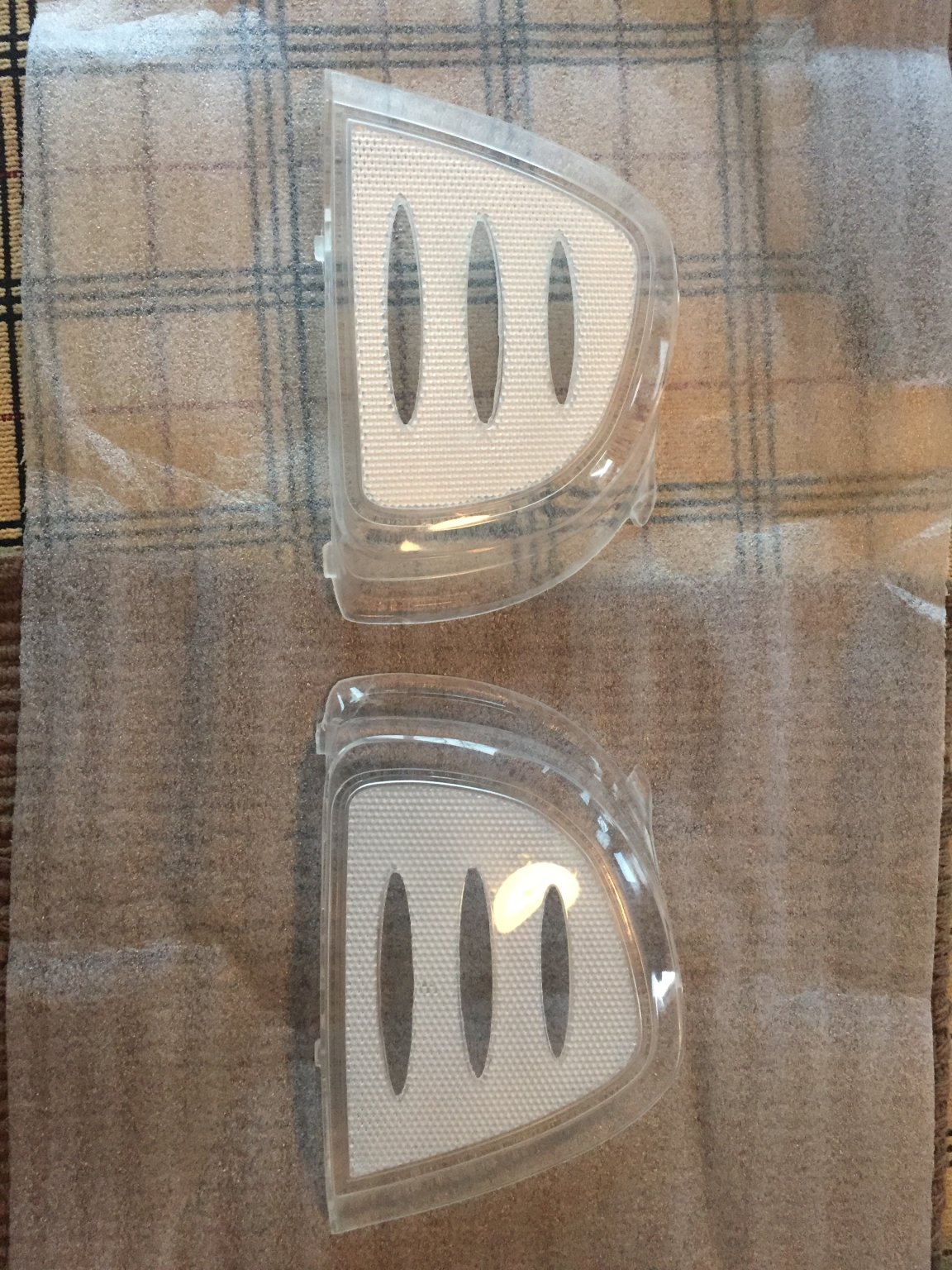

Ok wheres the how to for that mod?
I copied @05Single... Don't recall if he had a write up on his page or not. It's super simple though;
1. Buy these: http://www.ebay.com/itm/2-x-White-D...-Black-Case-/141607722158?hash=item20f87a5cae
Will need quantity of 2 if you are wanting to do all 4 lights. 2 lights come with each order.
2. Buy these: https://www.amazon.com/gp/aw/d/B00D...F8&qid=1475177166&sr=1&pi=AC_SX236_SY340_QL65
3. Wait for parts to arrive
4. Gut 3157 sockets until your left with just the socket itself, no wiring. Drill a hole in the center of the socket for the bolt on the light to pass through.
5. Bust out your drimel with a tiny cut off wheel and go to town. You'll need to trim inside of the socket so the light can sit down inside it and the bolt protrude out the back. I didn't take pictures, but it's pretty simple to figure out once you get going.
6. Test fit the light to be sure it all fits.
7. Modify the locking tabs on the 3175 plug to fit your stock taillights.
8. Cut your stock reverse light plug off and wire the LED's.
9. Enjoy
