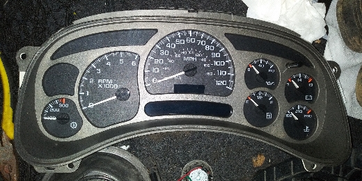

Here's one 2005 Denali he has that I like to put in my 2006 Yukon xl slt 2c4c61943a88e7b5bc0dcc226cd22042.jpg

How are the "PRND" different between '05 and '06? That seems to be the same cluster my daughter has in her '03 Denali.

NNBS in a NNBS. There’s a write-up on GMFS but I see their site is down for maintenance. You need to buy or build a harness, and the bezel takes a lot of work to take the two different ones, cut them in pieces and make them into one hybrid. But it sure looks sweet. https://www.gmfullsize.com/threads/escalade-cluster-in-nnbs.304181/

Thanks. Joined the forum... But how is transplanting a NNBS Escalade cluster into a 2008 relevant to swapping a 2006 cluster into a 2005? Isn't your example two GMT900s, and his plight is with 2 GMT800s?
Not trying to nitpick -- you know more than I do. I'm hoping for you to dispel my confusion. :confused:

He asked if his PRNDL would work since the display is different in the 2 clusters so I was showing that it doesn’t matter. Just an example of data displaying the same in clusters that are different from each other. Same idea, different platforms.

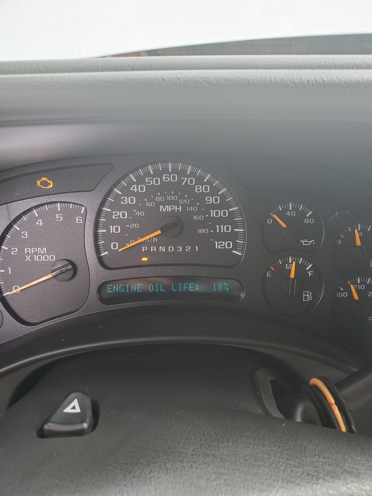

I will get picture of original 2006 for the gear selector it's just a orange Dot in 2006 and 2005 it's like little read out has gears on top.
