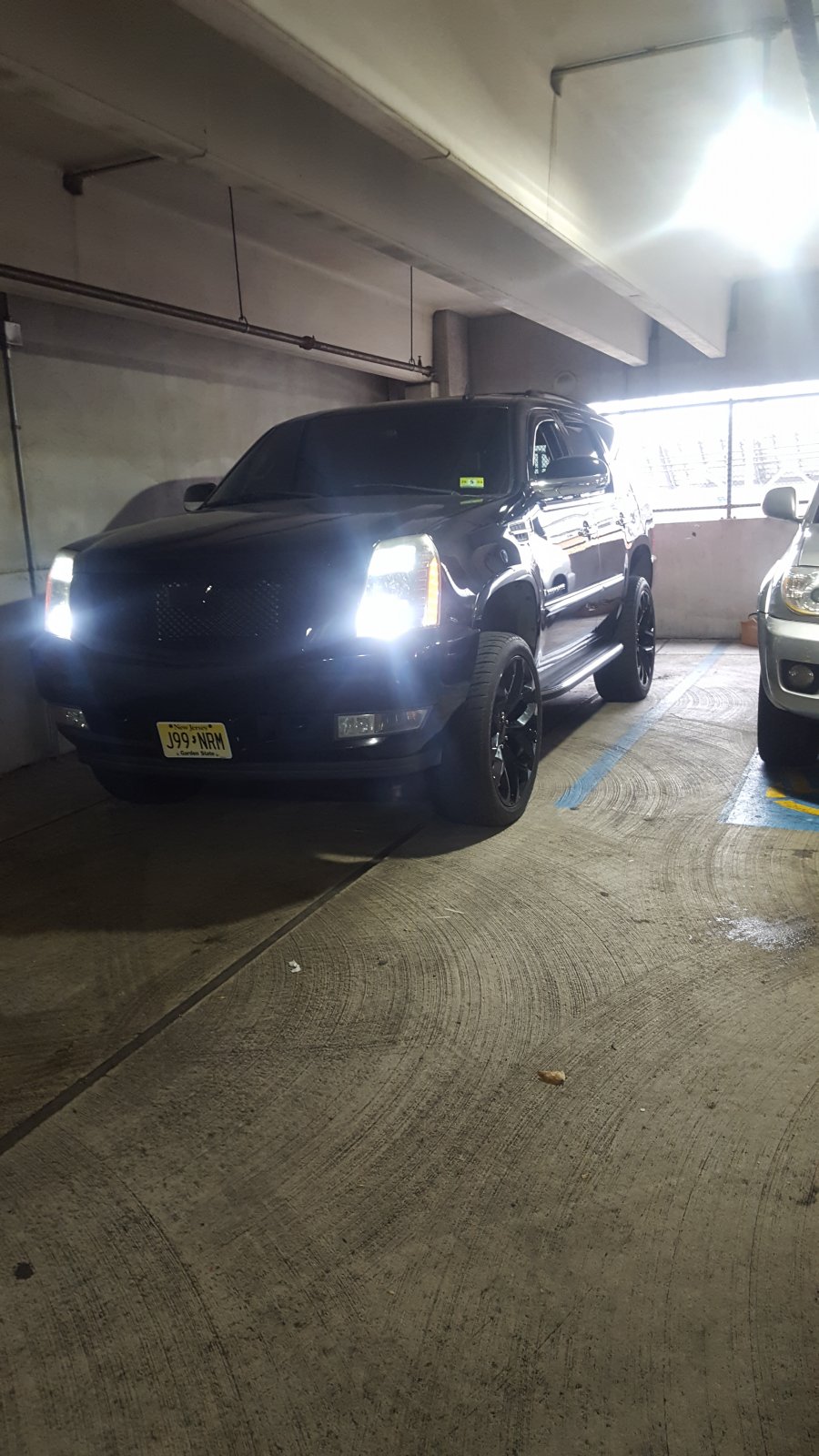

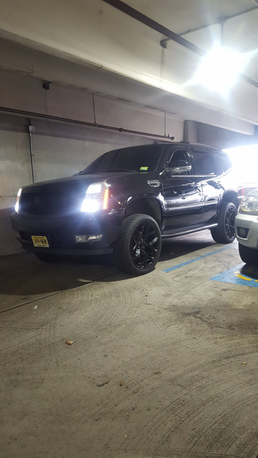

Just a quick update
Escalade is aligned and ready to drive. Hit a few hiccups before the alignment that had to be taken care of. I started another post for that.
35" tires are looking and riding good. Here is a pic but i will get better pics in a few days.

Do you have the factory oem front struts? If you do, you might be fine with out the 1/2" spacer. When i bought my escalade, it had oem front struts. Reason why i replaced them was because about a month later they started leaking. I didnt want to spend the money at the time so i went the bypass route and got arnotts. Right after the install i noticed that they kept the oem ride height. After a week or 2 of driving, the front started looking lower and lower. I ended up buying a rc 2" leveling kit for under the strut and that brought it up alittle over stock height.
I did notice that the oem front springs have 7 turns and the arnott have 6.
Right now after the rc 3.5 lift and the 1/2" spacer, the front still sits 1" lower then the back at 40" and the rears are at 41".
And to answer your question, yes i bought the 1/2" spacer front from motofab.
Not sure if you have the autoride but if you dont, might be easier to get the look your looking for. I think if i replace the rears with none autoride, my rear will drop another 1" and level out.
