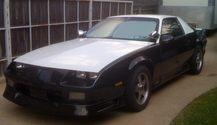

One of our other cars is a 92 B4C 1LE ex-TxDPS Camaro that got painted a nasty metallic blue. When I'm done with the restomod project on our 86 SVO, it's next. First up will be to restore the original black and white paint scheme.

Thats awesome
Love the Texas DPS colors on vehicles.
Ive made a couple of old foxbody coupes and painted them DPS colors, also painted a old 4dr fairmont DPS colors and had a 5.0 in it.

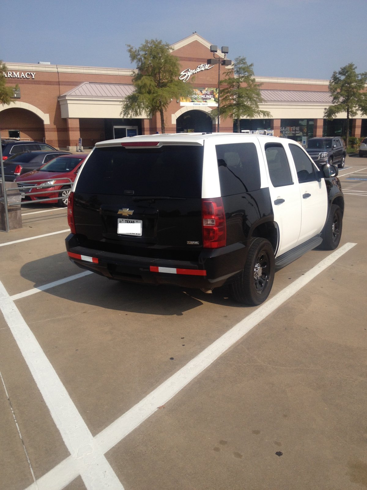

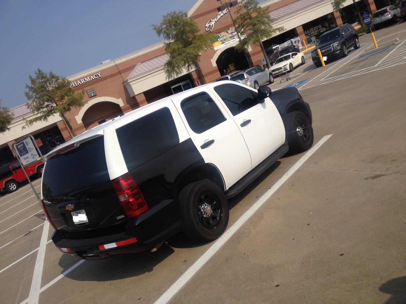

Spent some time waxing this thing, prob first time it has ever been waxed, also spent a couple of house using rubbing compound on the doors, especially near the prisoner doors. Looked like a few handcuff rashes on the rear doors.
