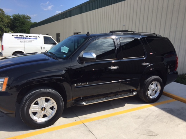

I'm not sure because it was done at the detailer, but as bad as they were I'm guessing they were sanded. I have another guy that comes by and does them for customers, he starts with a wet sand and polishes up from there. He finishes with a hard coating to keep them from yellowing. I can tell you the cheap kits suck.

I also do headlight restoration. I dry sand and depending on how bad they are, I work my from course to fine. I then finish up with a 3M buff, then with a two part uv protector that I mix together and apply. Comes out amazing. Only thing I can't get rid of is the plastic crazing, which is in the plastic itself. Nice job.
