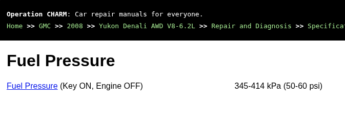

The KOEO fuel pressure spec is here, provided I selected the correct vehicle:

anyway other than a drop to 40 & then 35 the fuel pressure is perfectly normal
these engines do not run on 50/55+++ running psi unless it is commanded for some specific reason
NORMAL operating PSI is 43/44 (engine on), key-on/engine off should be 50-55+
the older gmt800's did run on 50-55 psi (engine on)
the only edition of the gmt900's that run on higher fuel pressure is the hybrids those run 55-60psi+.
It's all in the factory service manual
And the pump was not up to specs, but it wasn't the pump. (see bottom for explanation).
I tried that. The fuel pressure key on is 40 - 48 psi and fluctuates with every key turn. One time it will be 30, the next will be 48, then all random pressures with each key on test. The live data coincides with mechanical gauges exactly. Pressure drops even lower when the motor is running. The only other possibility is that the 15% ethanol fuel is more than the vehicle can handle (the owners manual says NEVER use any fuel that is more than 10% ethanol - and the fuel around here in Northeast Arkansas is running 20% and higher and the distributors are getting away with it and do so with impunity).
