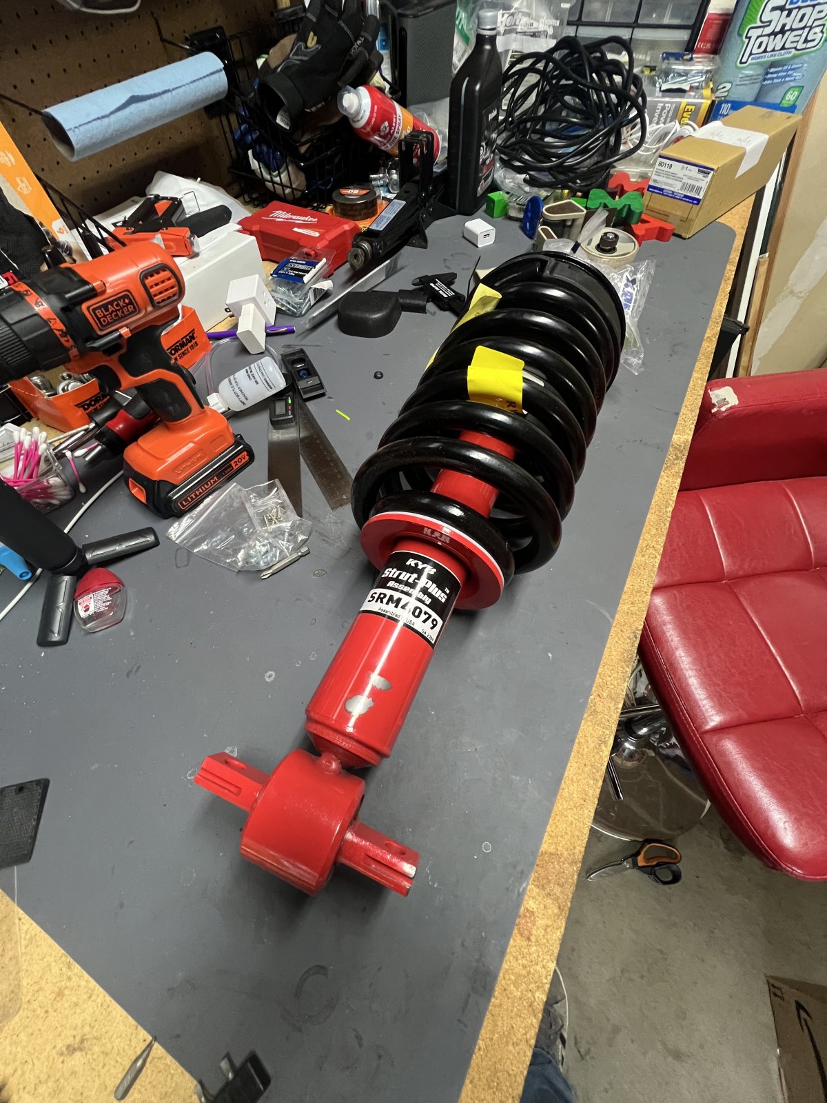

I ended up installing a pair of KYB SRM 4079 Truck-Plus quick struts. I have bypass resistors coming in the mail tomorrow and I’ll be installing those to disable the service suspension light. I’ll be installing Moog 81071 springs in the rear with a pair of Bilstein 4600 shocks this weekend to complete the auto/air-ride delete, followed by an alignment. I may opt to replace the compressor and add air ride shocks in the future but for now I think I’ll be happy with the passive shocks.
Very impressed with how the KYBs ride. The front sits about an inch higher than before. They are firm but very responsive, and they recover quicker from bigger bumps than my soft worn out autoride shocks. My stock struts were so far gone anything would have been an improvement.
The KYBs were $500 for the pair. The Bilstein 4600s were $160 for the pair, and the Moog rear springs $70 for the pair. Resistors were $24 total, so I’ll be out $750 to replace all four corners. Definitely worth every dollar!

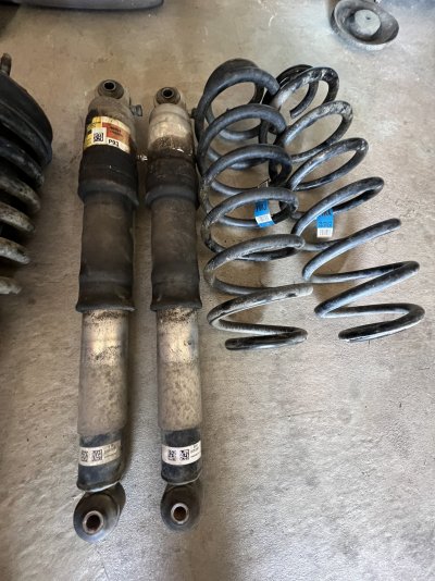

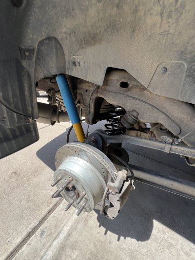

I finished swapping out the rear today for my air-ride delete. Bilstein 4600 with Moog 81071 coil springs and Moog K160072 insulators on top and bottom of the new springs since the old ones were worn out. I’m completely impressed with the KYB / Bilstein combo, and the truck handles much better. The handling is firm and the new shocks / struts are way more responsive than my old worn out ones.
Glad I rolled the dice. Truck drives great and handles much better than before. Total cost was $750 in parts for front and back.
