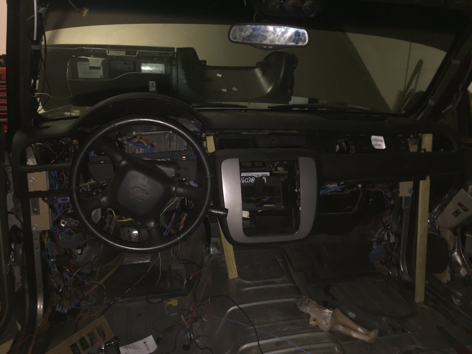

Status update on my project... My 2010 dash is out for delivery... Only took 2 days to deliver to my office here in Florida... This is what they sent me... More pics once it's in my possession...
I
Izusu472
Oct 26, 2016
17
14

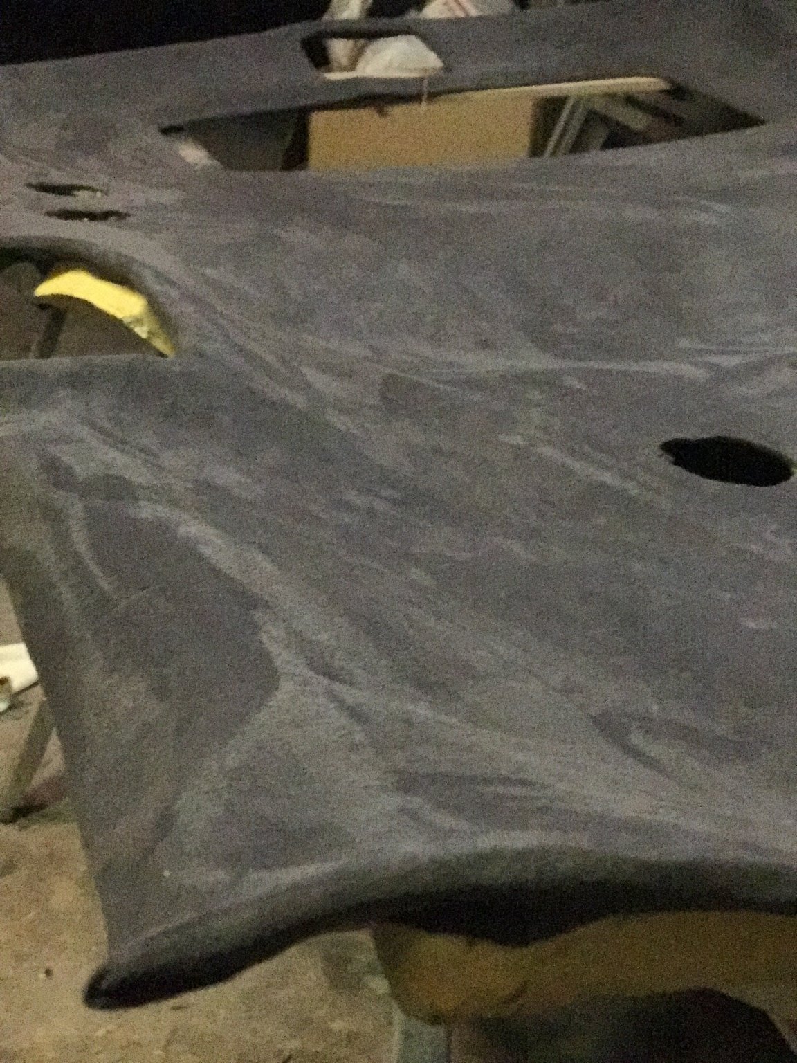

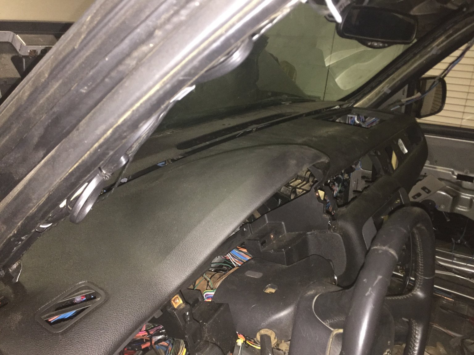

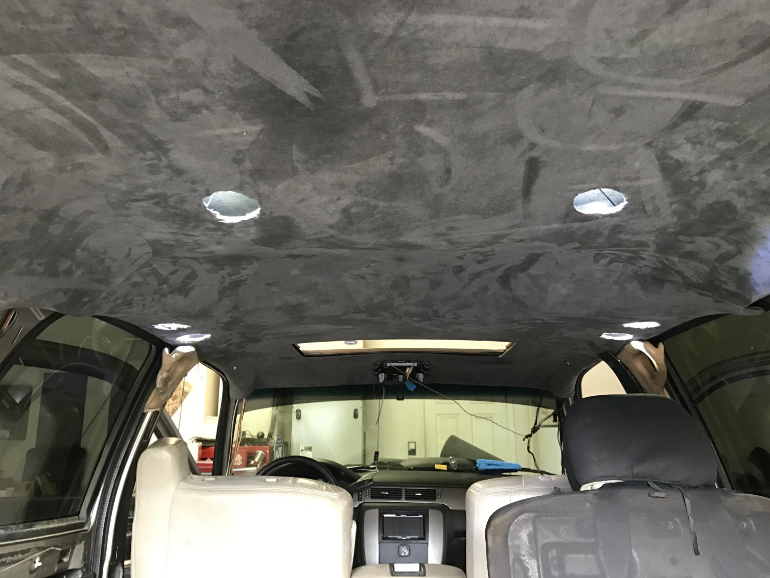

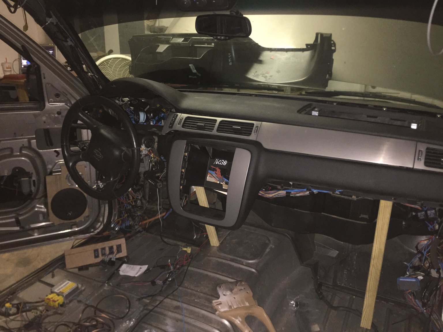

IMG_3160.JPG IMG_3161.JPG IMG_3162.JPG IMG_3163.JPG It's going to be a busy weekend but here's a little sneak peek of how fast and hard I've been working on this build... Everything from the headliner down to the carpet is getting a makeover... I wonder if anyone has tried to do this 01-06 to a 07-13 swap before and if so how far did they get... It'll be pretty kool to be the first one to accomplish a project like this... I have pics of everything I have done so far this weekend and I know I'll have even more by Sunday...
