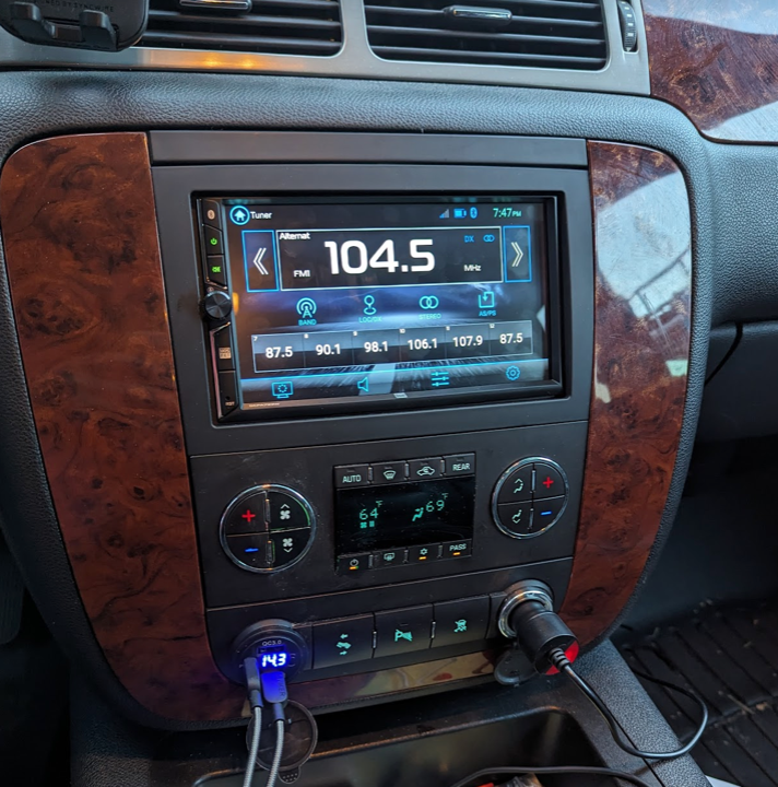

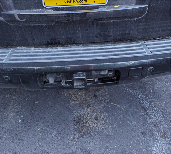

Crutchfield "Dual" branded unit in. Its very basic, which is exactly what I wanted. Basically its an AM/FM radio, reverse cam and vehicle to use Android Auto (wireless). Works perfect.
I also rewired both front power plugs with relays to be ignition switched (changed out the drivers side one for a QC/PD flush USB port) and added aforementioned camera. All in all, very happy, sounds great.
