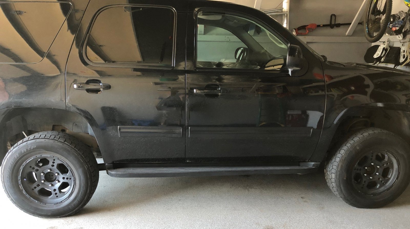

Hi all. Ok I finally got the parts and did the lift. I used motofab's 2 inch lower strut spacer up front and their 1.5 inch coil spacer in the rear. The front went from 36 inches to 38 and the rear went from 37.5 to 39. I also replaced my rear shocks with pro-comp ES9000s. The install in the front was standard stuff although I did need to disconnect the ball joint and tie rod to get enough room to install the bolts the correct way. In the back I ended up using my spring compressor to save time. Since the coil spacers are powder coated aluminum I lined the inside of surface that sits on the frame with some leftover sticky back rubber windows flashing in case there would be any metal on metal noise. So far so good. Although I'm afraid that I must try and curtail my instinct to go bigger/higher in the pursuit of long travel. :)
redshift
redshift
Jul 15, 2020
19
13
Came out great! - What kind of rims are those?
You know they came with the truck and I had a heck of a time figuring it out, but they are discontinued liquid metal gaitlins 17x9 with, I think a -10 offset.
