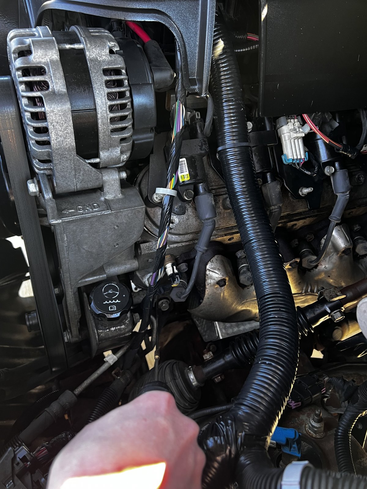

Hi all, I just recently bought a 2012 Yukon XL Denali with the 6.2. It has developed a noise that I can’t identify. It has 214k on the miles.
Noise is coming from driver side and can be heard from under the hood and in the wheel well.

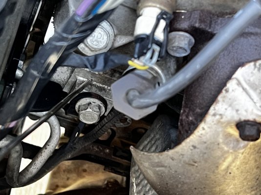

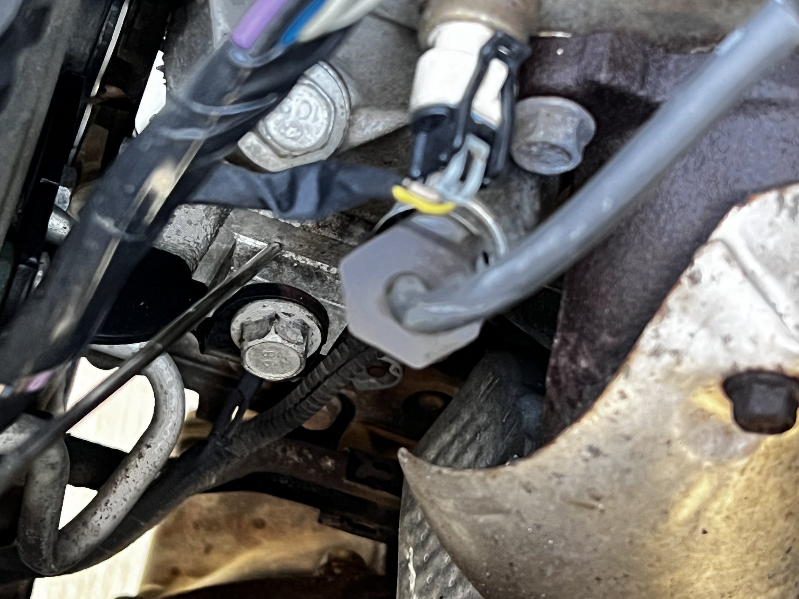

Checked the exhaust manifold bolts and all are there except one on passenger side.
