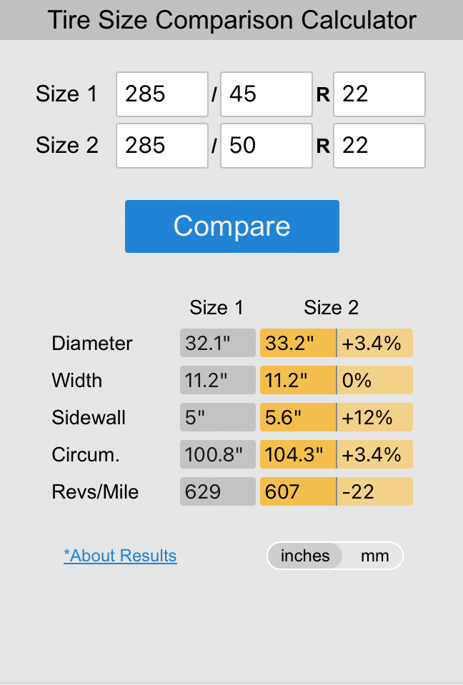

Thanks. If I stick with the 20's, that would be an option. Per the calculator, and if we go with the 22's, assuming a 285-50-22 (instead o a 285-45-22) would be a little over a half of an inch closer to the top of the wheel well vs. the stock.
