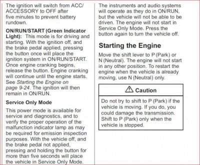

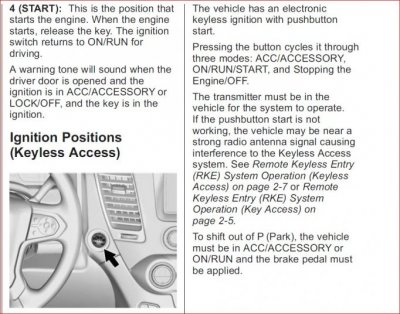

Just read the manual. It states that one can shift out of park in acc mode while pressing brake. THIS IS INCORRECT on my truck.
It also describes Service Mode Only, what i was after, push and hold for MORE than 5 seconds. I previously gave up when the DIC lit up and said press brake to start.
If you keep holding the button, which seems like forever, it will light up the whole dash and instrument panel. At that time I can shift to neutral.
Glad I found this, before actually needing to.
So, do I take this up with service that I can not shift to neutral in acc mode? As in something is wrong? And I guess my dealer/service hasn't had to put a Push To Start vehicle into service mode. I will inform them of Service Mode. This is a Certified Service Dealer, whatever that means.
