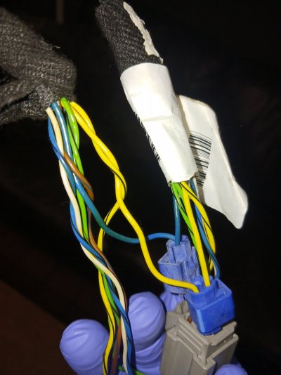

Hello,
I’m in Texas and I recently purchased a 2016 PPV used by the state troopers.
It’s in great condition overall.
Radio works, but only plays audio to the two rear door speakers. The front door and dash speakers do not work.
I will be putting in a new center console, but want to figure out the speakers first.
Pictures are attached, I already removed the metal police console, there are both in tact wires and multiple cut wires (I assume are police gear wires)
Thank you for the help in advance, I already love this Tahoe!

On the same connector WX7 wiring harness splice your blue wire and solid yellow wire.

Figured out the speakers! All of them work great.
If anyone is having the same problem- it was super simple to figure out.
I looked up the color of the speaker wires, located the harnesses below the dash. It looks like the police installation separated the (factory) harnesses connection, and installed two auxiliary ones once separated with some custom wires. I just unplugged the two and connected the originals.
Look at the picture I attached for visual. The red lines indicate how I received the PPV, and the green line is how I attached the cables that now work. I attached the wire colors I used to locate the wires in the mess as well
