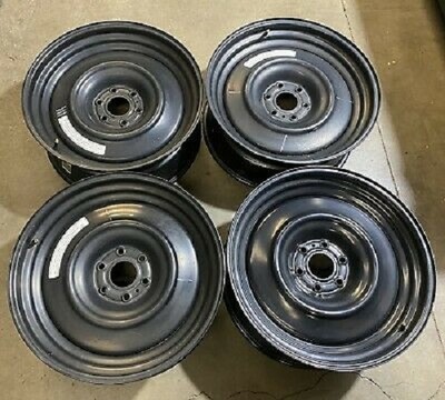

fiind a color you like, i am sure they would look good
i have a transit rim for my spare
I wanted this for my spare but couldn't find a deal on a single transit wheel. I ended up buying a stock GMC wheel and tire off Marketplace for $100 since the 20" tire OD is more than close enough to the 22" tire OD I'll be running. I'll de-clad it and replace the 17" spare that won't fit in the front due to the spindles.

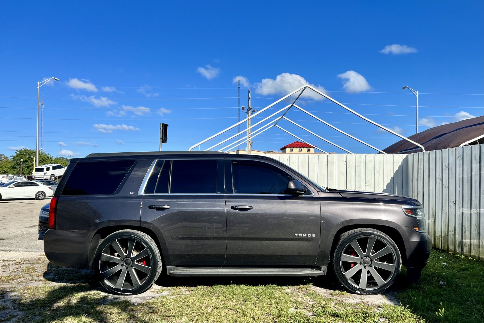

Now THAT is pretty effin' cool. It's different and it all fits together pretty well. His, being a truck and black, makes it an easier match. Picturing that setup on your Tahoe as it sits in that pic you posted doesn't quite work, IMO. But, you're here to prove you can make it work and I, for one, am anxious to see it happen.
Like I said, maybe something as simple as blacked-out trim is all it needs. Where's a good Photoshopper when you need one?!
Yeah his truck looks amazing and it really made me feel better about going in this direction.
I wish I can photoshop to see how they would look. That would be ideal!

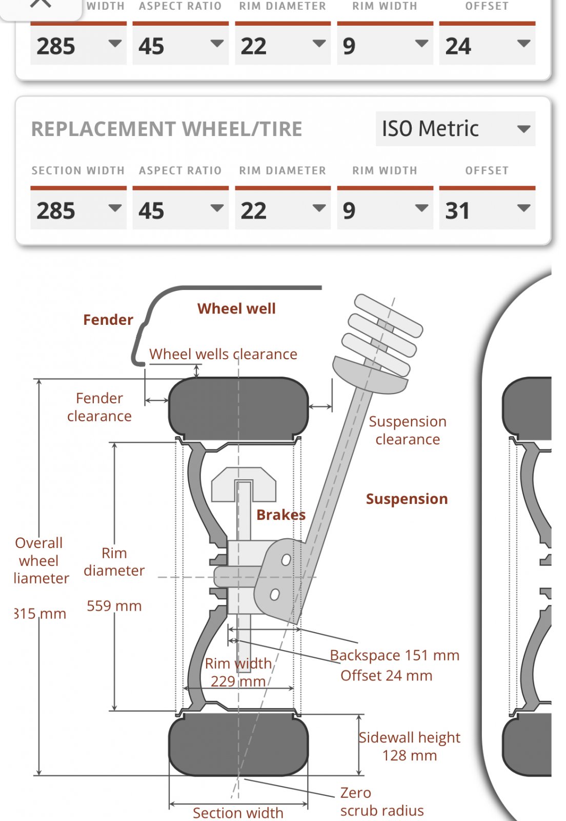

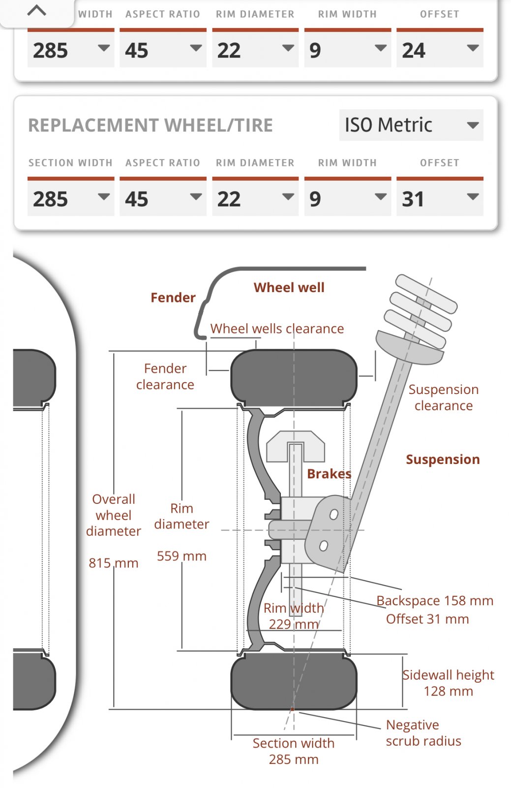

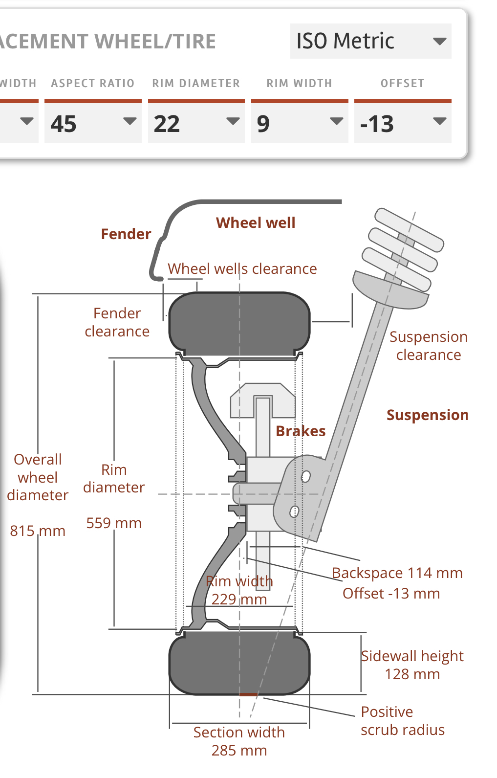

And why wont the 22” fit?
"Our 22" Wheel will be out to far as we max our backspacing out to 4.5" , However we can do our 20x9 with a 5.75" Backspace which will tuck and be just inside the fender ."
That was their response to my email.
