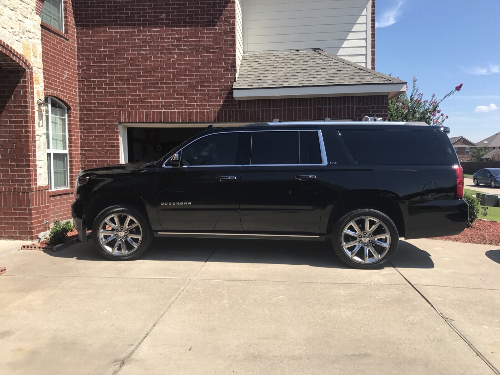

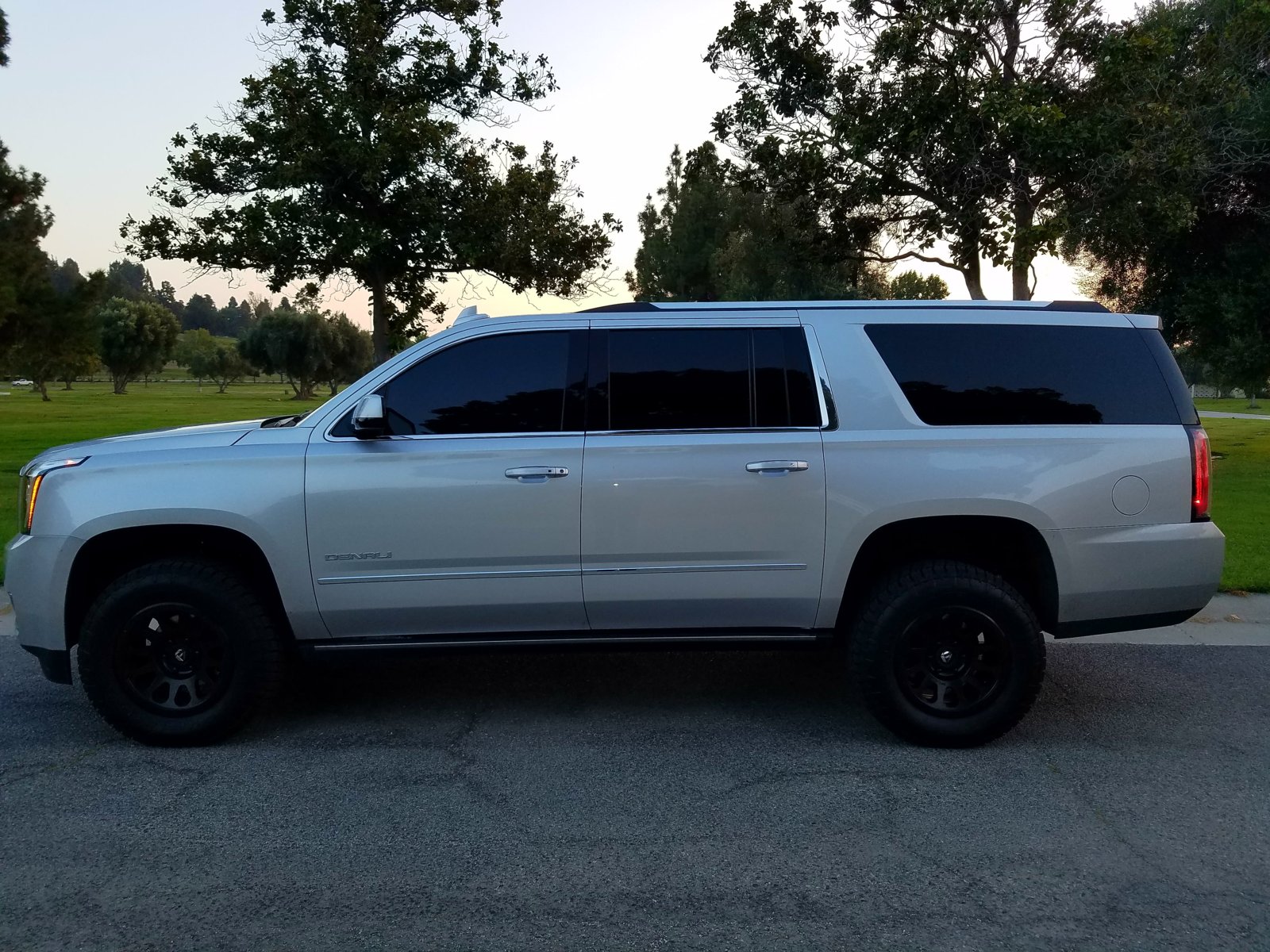

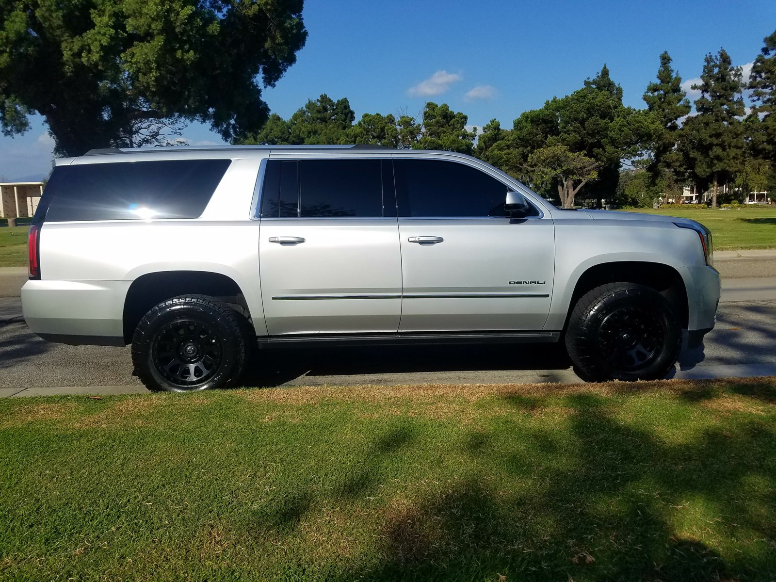

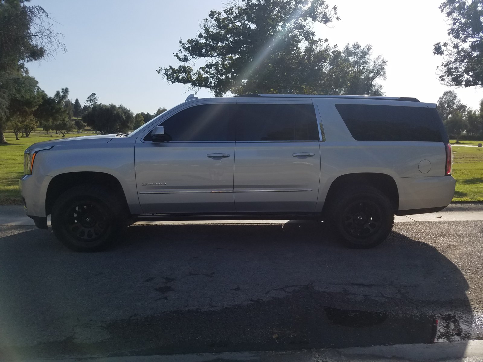

so I called fabtech they sent me a 1 inch lower rear spacer so here is the new pictures
View attachment 182494 View attachment 182495 View attachment 182496
I had this same issue! Looks like a leveling kit with the rear way high! I also had it done at 4wp. Fabtech also offered me a lower rear spacer, I didn’t want that since it wouldn’t give me the lift look and only the leveling look. And for nearly $4k that didn’t seem right. I had a level kit on it before and the final solution was 4wp put on the bottom 1.5” spacer from another lift and it helped even it out better. Attached is the level kit pic, 4” fabtech lift kit, and final the 4” plus the 1.5” to make it really a 4” kit. Only about another $50 in parts to get what you want. 8da2ffecb49cfe039de9ad4c2709504d.jpg86bc8853d0fefeb4d9467add49dffb6d.jpg95ba5011197eb901e992cc7630da453d.jpg
