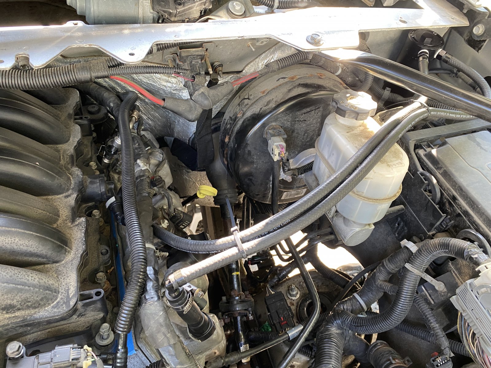

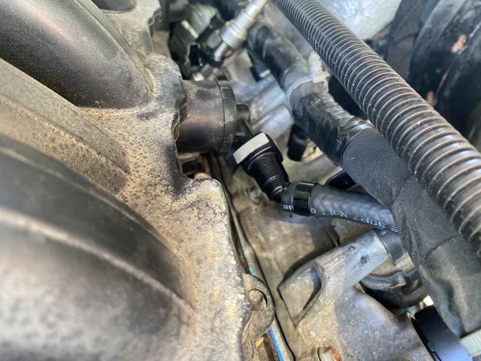

What I am going with for now is to run an inline PCV from the drivers valve/rocker cover to the stock intake manifold port. I threw a catch can in the mix for good measure but its essentially that. The passenger valve/rocker cover will continue to source clean air from the airbox, as it was intended from GM. So the system should function like stock, except the direction of flow of the drivers side rocker cover will be an OUT instead of an IN. Other GM engines have used this arrangement in the past so, in theory it may be just fine.
Some consideration was given to the orientation of the PCV valve as older designs which used an inline PCV in the horizontal alignment tend to get gummed up and don't "self clean", so I selected a vertical arrangement with a 90 end on it for this reason. I used a random hose clamp for now to hold the PCV while I order a suitable spring clamp. All the GM vacuum hose fittings were repurposed from their original parts. I think it came out okay.

I don't know much about this system, but I would ask why you can't simply drill and tap a hole in the intake manifold and put your PCV valve there?
I can't imagine running an engine without a PCV system, even lawnmower engines have them. The purpose of the valve is to prevent a backfire from getting into the crankcase, which could blow out the crankshaft seals and the dipstick.
