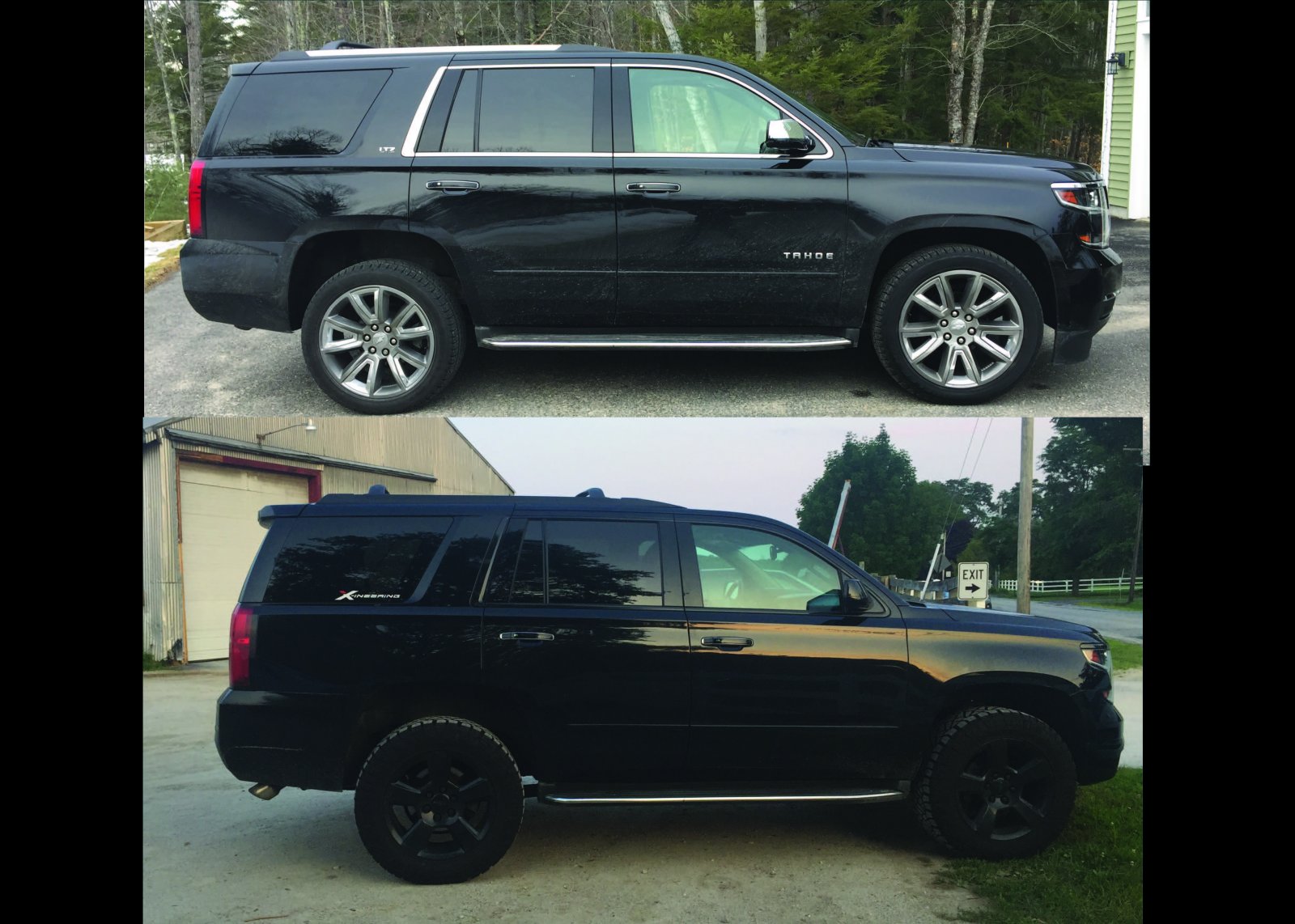

Great looking ride. I have a 2019 midnight edition z71. Was curious where you got the black trim that was chrome?
I've used a local vinyl wrap service to "delete" almost all of the chrome trim on my LTZ (plenty there...)
I live in Maine so I don't know what kind of services may be in your local area. My wrap guy has included a 3yr guarantee on his work. I believe I paid around $300 for all of the vinyl wrap product and labor. So far so good, it's been almost 2yrs since installation and so far so good.
Also removed the three chrome "Tahoe" decal pieces from side doors and rear gate.
Satin Black vinyl wrapped pieces include:
Eyebrows over the headlights
ALL pillars on front and rear doors - Already black on a Midnight edition
ALL 4 windows' thin surrounding trim
Rear Bumper thin horizontal strip - Already black on a Midnight edition
Roof Rack running rails - Already black on a Midnight edition
New Parts (Pre-Painted by Chevy):
Black RST Grille
New Parts and Black Paint to Match:
Side Mirror Covers - Already black on a Midnight edition
z71 Front Bumper & Fascia - Already black on a Midnight edition
z71 Skid plates (3 total) - Already black on a Midnight edition
Side Steps: Still have the original steps that came with this 2015 LTZ. I went through the process of trying to purchase some different steps (not OEM z71's) that turned into a nightmare. After 5 months and 3 returns, got my $ back and decided to just sit tight.
Ended up spending about $10 at HD on some PlastiDip spray cans and did the "chrome delete" with that stuff on the side steps. Really not that difficult, just took a little time and patience. I did remove my steps completely for painting though. It's merely a fix for right now, the chrome steps scream out now that the truck is mostly blacked out. I have to say, the PlastiDip is NOT a solution for any vehicle part that will see any wear and tear. It took my 7 yo kid all of 5 months to start ripping the PlastiDip off the step when getting out of the truck.
Before & After photo I messed around with a while back trying to compare exactly what you're asking about (note - PlastiDip not yet applied, in the process of the steps nightmare):
