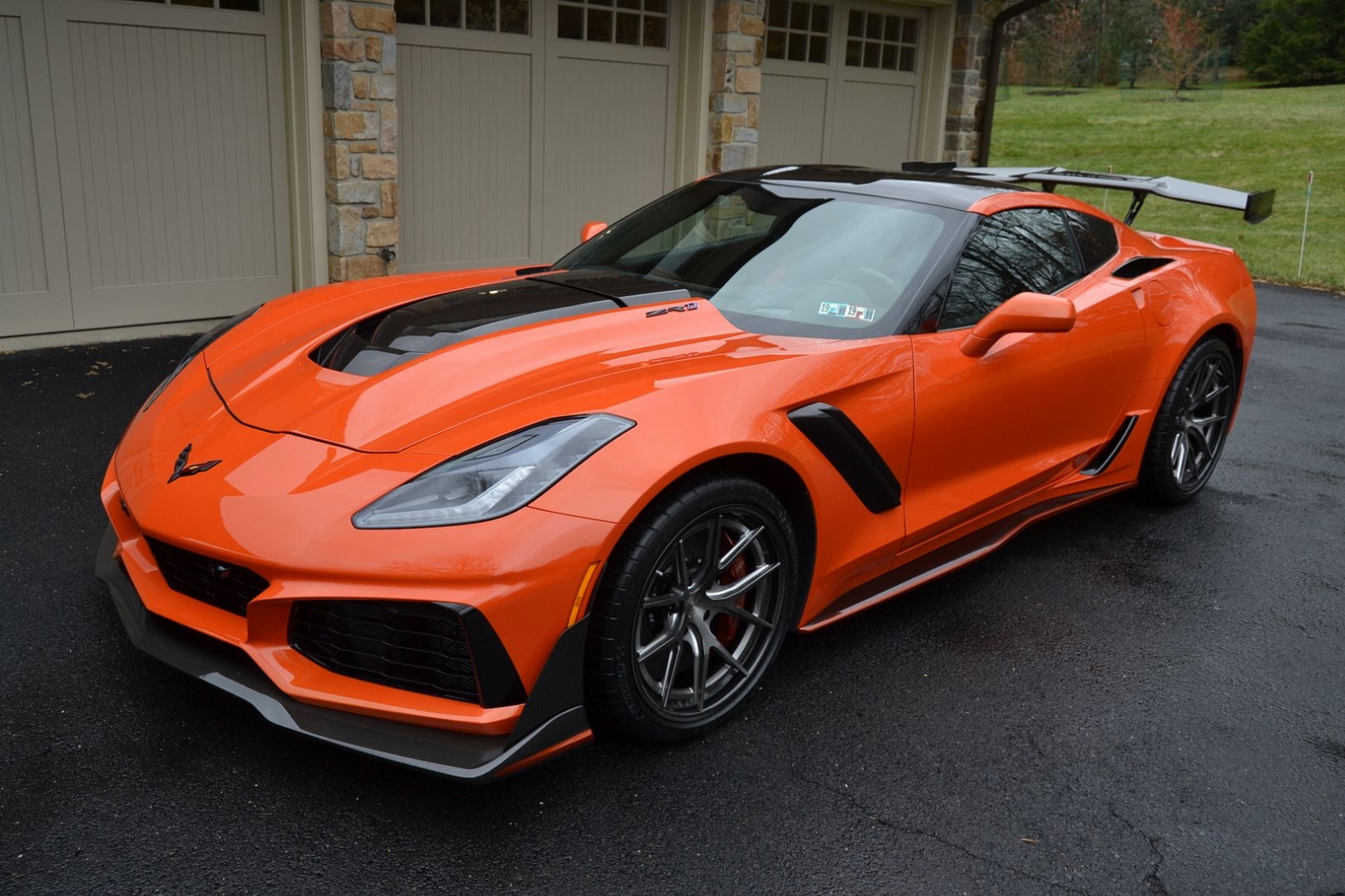

They will get the 2020 does soon, it didn't take them long to unlock this 2019
And Callaway took care of this one, with warranty

Can I marry your daughter (and borrow the keys)?
