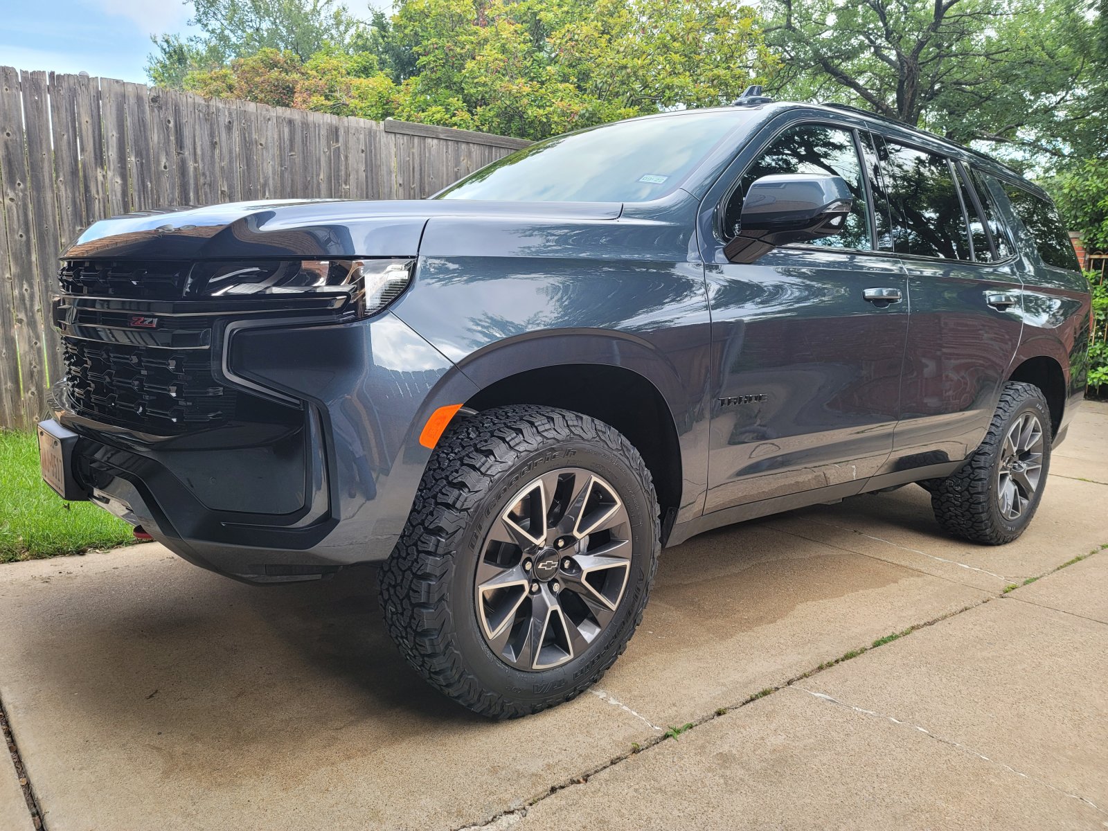

What size wheel spacers did they use and are they hub centric?
I didn't measure the spacer but it looked like 1" to 1-1/2" to clear the front caliper. Since it's using spacers I would assume lug centric (no vibrations)

okay thanks. did you mean "Hub Centric", they have less vibration. (Same size as stock hub)

Yes I meant hub centric. Drives smooth.

OK. Stance looks really good, just right amount IMO. Any way you could find out the make and size of the spacers they use. If not, no big deal. Would like to push my wheels out just a tad.

I'll find out soon. I ordered mud flaps but gm said they are back ordered. Also I hate the spongy brakes, I want the brembos.

Stuck my phone in the wheel and was able to see the label. 1-1/2" spacer. It's on ebay for $66 a pair. The hc stands for hub centric. 20201013_125456.jpg

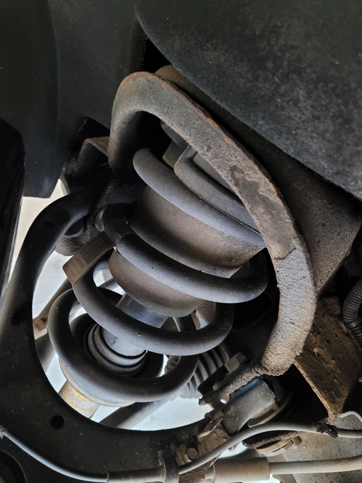

Leveled today. For those looking to level, I installed a Motofab 1” strut extension. Anything more than 1” on these new Tahoe’s (at least the Z71) will put the front end higher than the back. This is within 1/8” of level per the dealership measurement. Have noticed no change in ride with the lower strut extension.
