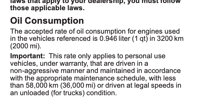

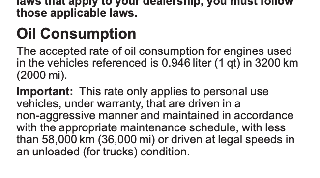

As much as I hate to say it, unless you are consuming more than 1qt every 2K miles, GM is going to call it normal..and no dealer is going to be able to change GM's mind...below is an excerpt from a bulletin on Oil Consumption, see here for full details.
Why does GM say that this rate of consumption only applies to vehicles under warranty? Are they implying that that the consumption increases when you hit 36K?
