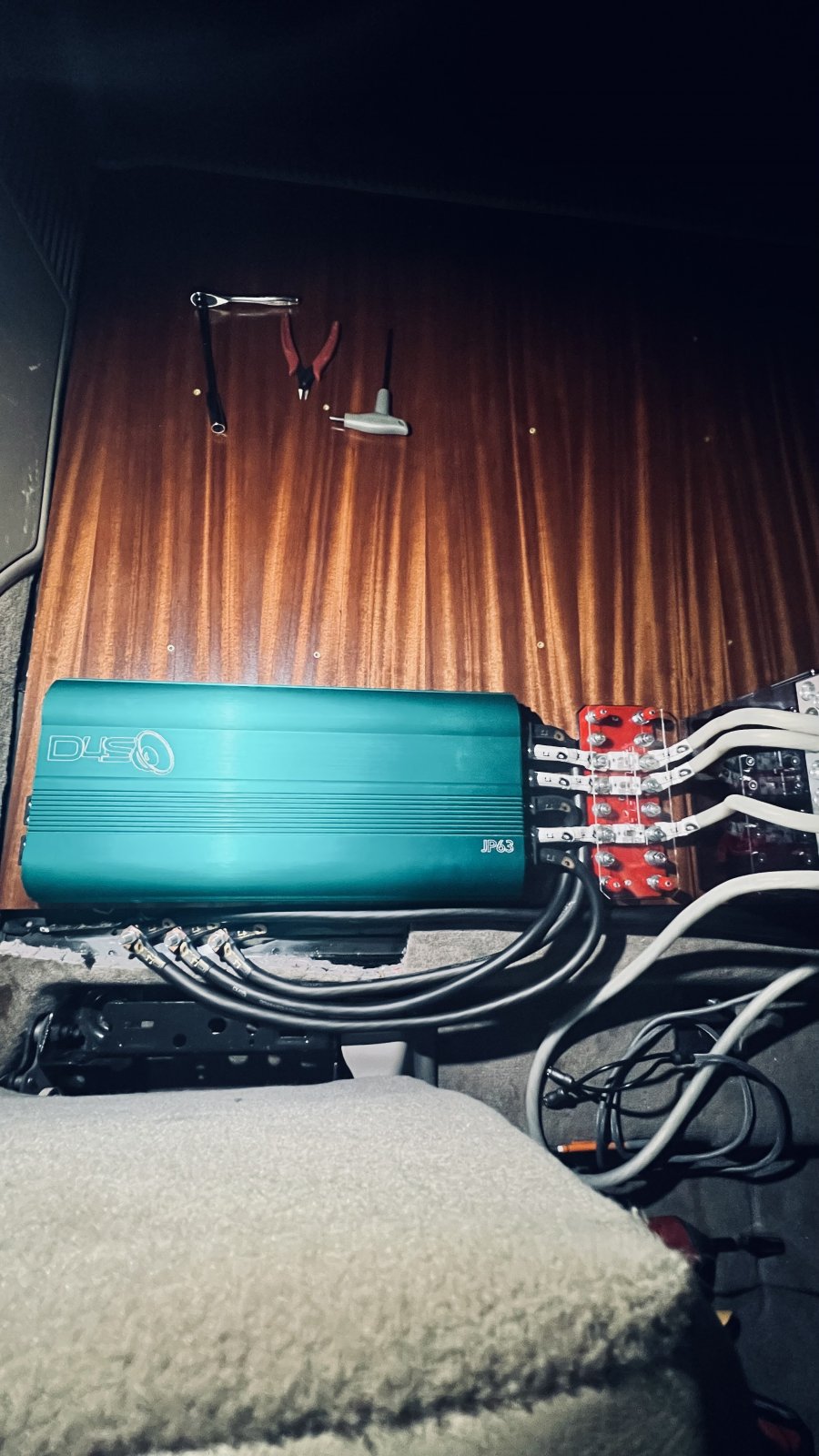

Was looking at the D4S amps, picking up an Orion XTR 2500.1 local for a good deal later today; fits perfectly under the 3rd row seat w/good air flow around it....as I always have the AC turned on for the feet as well as vents. Was running an X15 with SCV-3000D in my F250, but that already had 2 batteries and didnt drop below 11.5 if I recall. But I will be needing a secondary in the AT4.

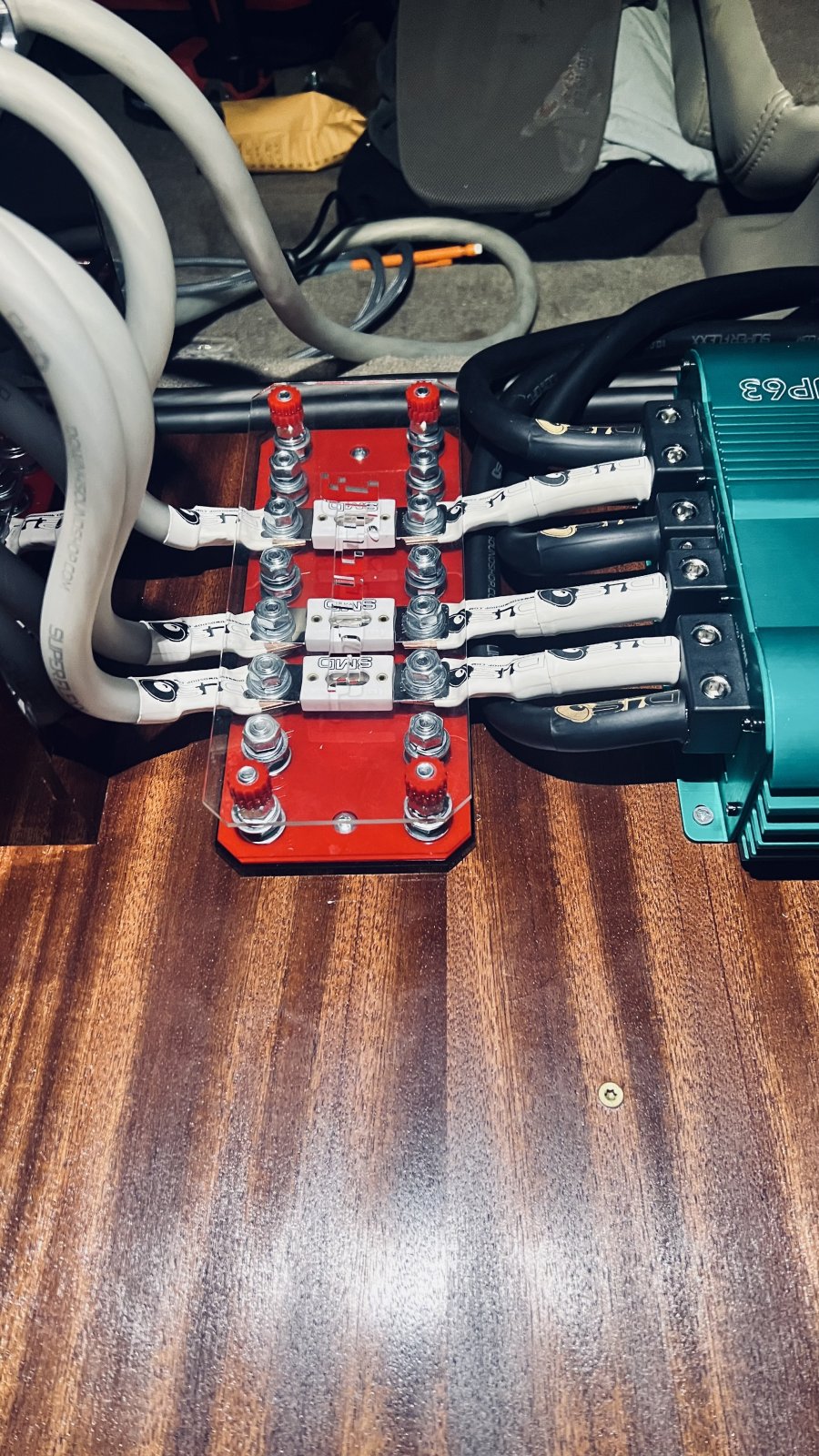

Perfect fit. Now to mock up a panel to mount it to with short rubber stand offs for shock damper and also air flow under the amp.
