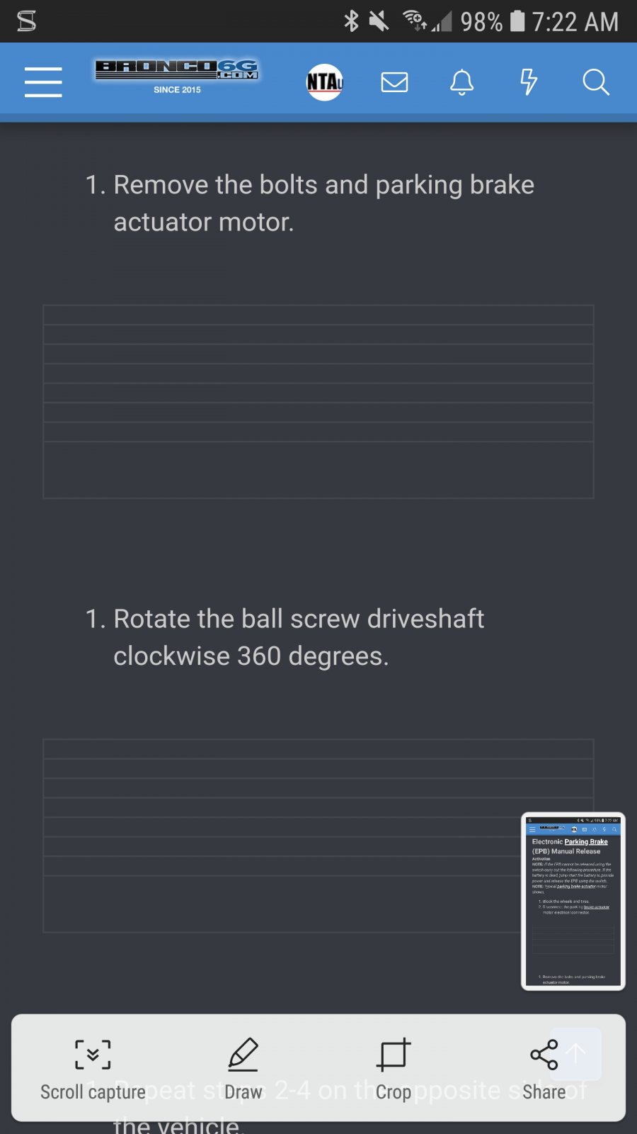

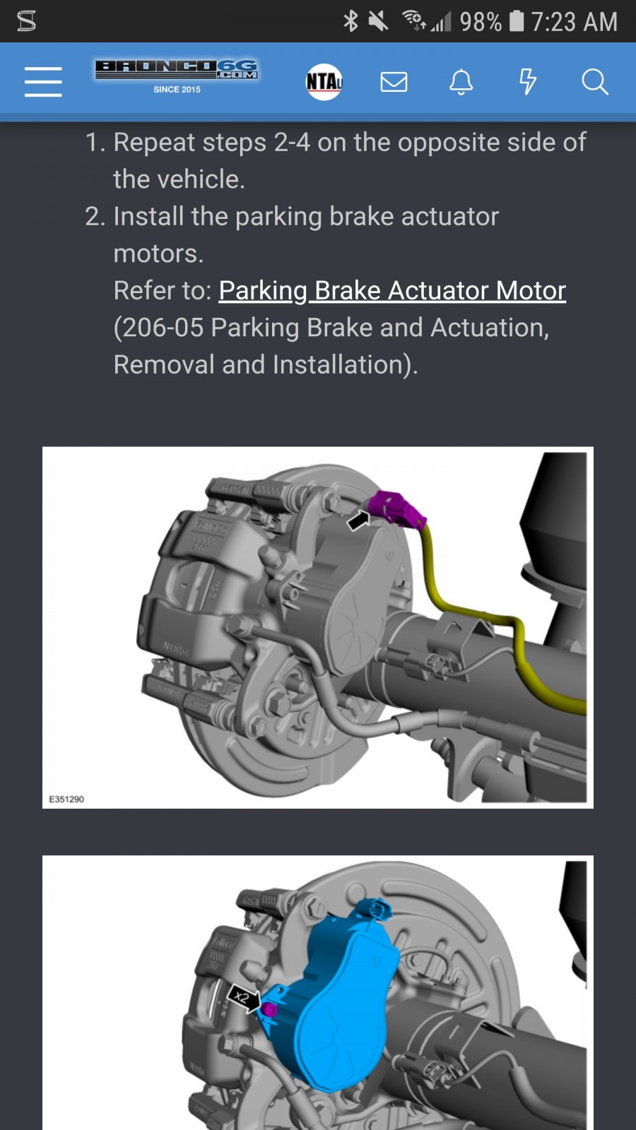

Our 2021 bronco had electric ebrake. It too auto released under throttle. We had a manual transmission too so ebrake was necessary.
I can say that ours locked up ONE time in the garage. When these electric ebrakes lock up your car wont budge unlike cable design. It happened IMO because I was using the auto release 100% of the time. It was also kinda cold when it happened too but not too bad here in desert inside a garage.
So I sat in my garage for 5 min playing with the unlock sequence. Turn car off/on. Press the button etc. Then I pressed the brake pedal down while pressing button again and bingo it unlocked. Since that day until we sold it for our 2019 Yukon the ebrake never on bronco locked up again AND I never auto released it under throttle again either. I always pressed the brake pedal then hit the ebrake button whether I was parking or going. I suggest doing same if not already. I also like having old style cable ebrake in my 2019 again.
Curious do the electric ebrakes also offer an emergency option whereby you pull or press and hold the button to aid in quick stop in emergency? The broncos had this feature although only a seasoned car driver would likely ever know how to use it if needed in emergency.
Ps-I pulled some pics from my old bronco build journal (over 1K pics) on this topic. I know its diff brand but electric ebrake sticking issue likely similar. Plus what one guy said he did to get it to release. Hope this helps. Note I had to post last 2 pics in another comment directly below, only allowed 5 pics per comment.
Screenshot_20220215-072250_Samsung Internet.jpgScreenshot_20220215-072257_Samsung Internet.jpgScreenshot_20220215-072306_Samsung Internet.jpgScreenshot_20220215-072315_Samsung Internet.jpgScreenshot_20220215-072328_Samsung Internet.jpg
