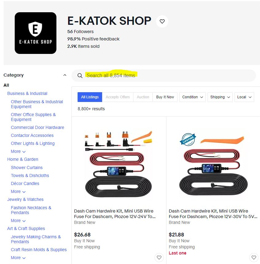

it's mini usb, so you will probably want something like this, has everything so you can just use a existing fuse and all you have to do is run the wire and attach the ground
I just used one myself to hook up a dashcam in the wifes burb.
Thank you sir.
