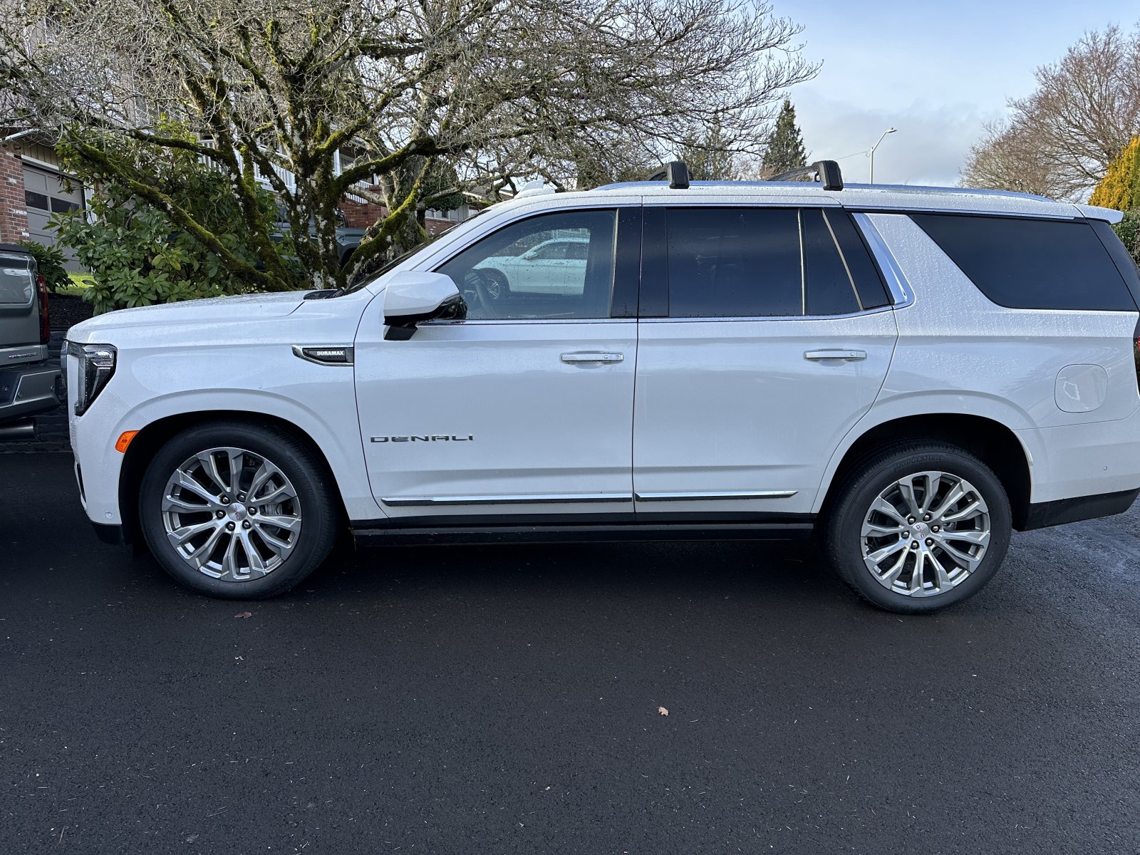

Three inches of shrinkage is no bueno!UPDATE: No improvements since I got the vehicle back from the dealer. The front suspension still drops when parked. The longer it's parked, the more it deflates. I've begun measuring the distance from the ground to the bottom of the wheel well on the fender, and it drops over 3" when it sits more than one overnight period. I talked to the dealer again and sent my service rep the bulletin that was posted above (thank you). He showed it to the tech that had worked on my vehicle and said that they were ordering the parts or kit to replace and/or repair the front air shocks. Hopefully that does the trick. I'll post another update once the repair has been made.
I have a 24 Yukon XL Ultimate Duramax that also seems to settle a bit overnight. I'd love to hear the cause, other than a pool
