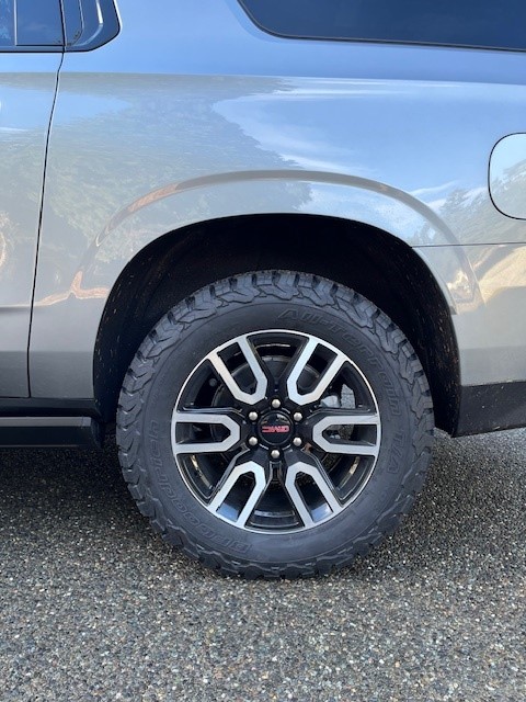

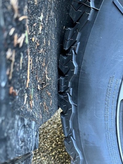

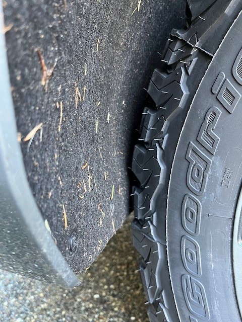

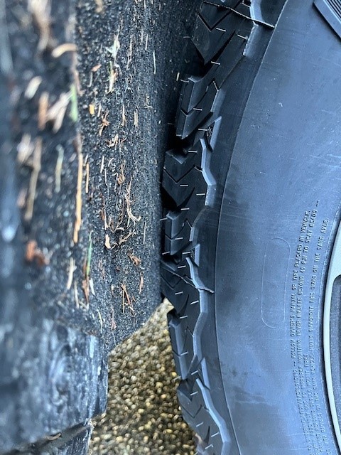

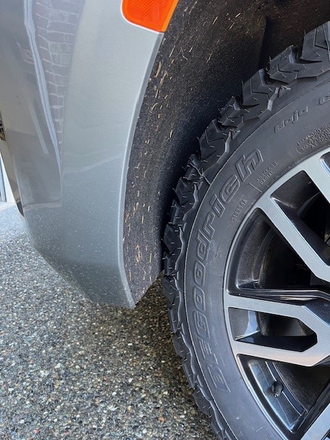

OK, here is the verdict. Delivered from the factory with 2 miles on it I took it straight to the tire shop. Elected to go with 285/60/20 BFG KO2's. This size is approx 1/2" wider and 1/2" taller then factory tires. At "Normal" ride height here are the photos of the fitment. It DOES rub on the back of the fender liner, but just barely. I have not pulled into any steep driveways yet to see how bad it is. Definitely cannot do any off road trails without rubbing, but that's not what I bought it for.

If you want to fix the rubbing, watch the Westcott Design fender liner pull back kit videos on YouTube. I did a nearly identical mod without their kit and clear an even larger tire. Their kit should make the mod even easier.
