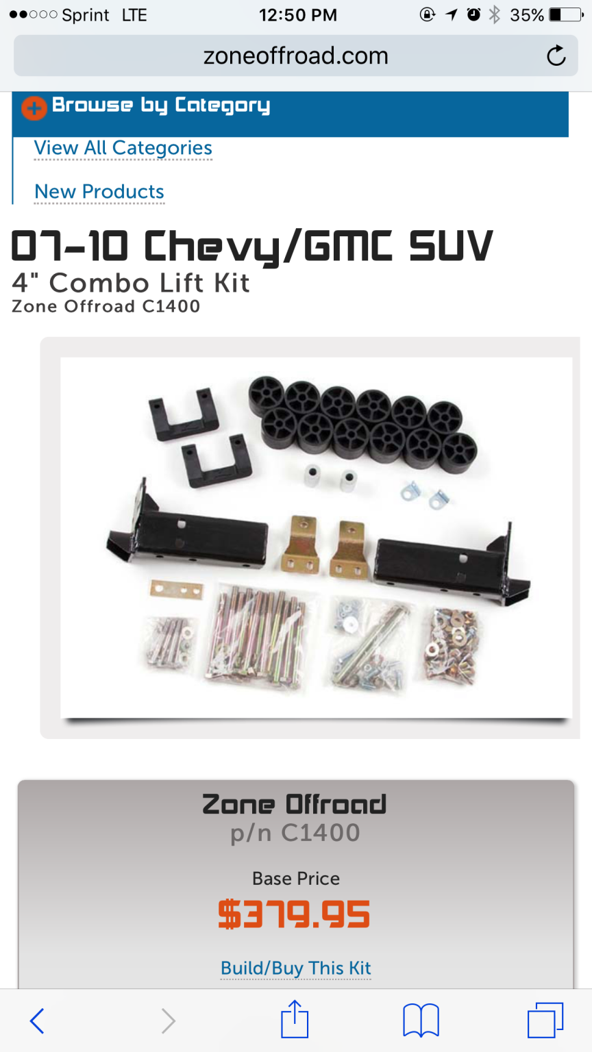

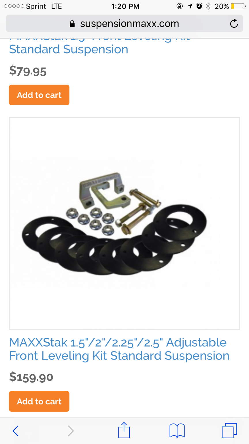

I'm sorry I'm asking so many questions or not getting it but are these the two kits you recommend
No any 2" front level will work but if you have ride height rods for electronic dampening up front then I would get suspension maxx since their kit has brackets for the level. Then order a 2" zone body and done with total of 4".
