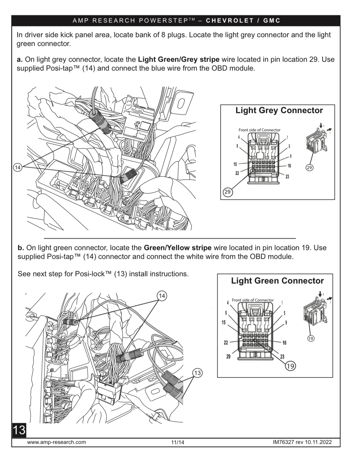

I seen this on Amp research directions for their electric steps, anybody know exactly how to wire each light based off this picture?
That module (BCM) is located under the dash on the driver side. Remove the carpeted close-out panel and look up in there to see the module with the connectors that match what's shown in the diagram.
