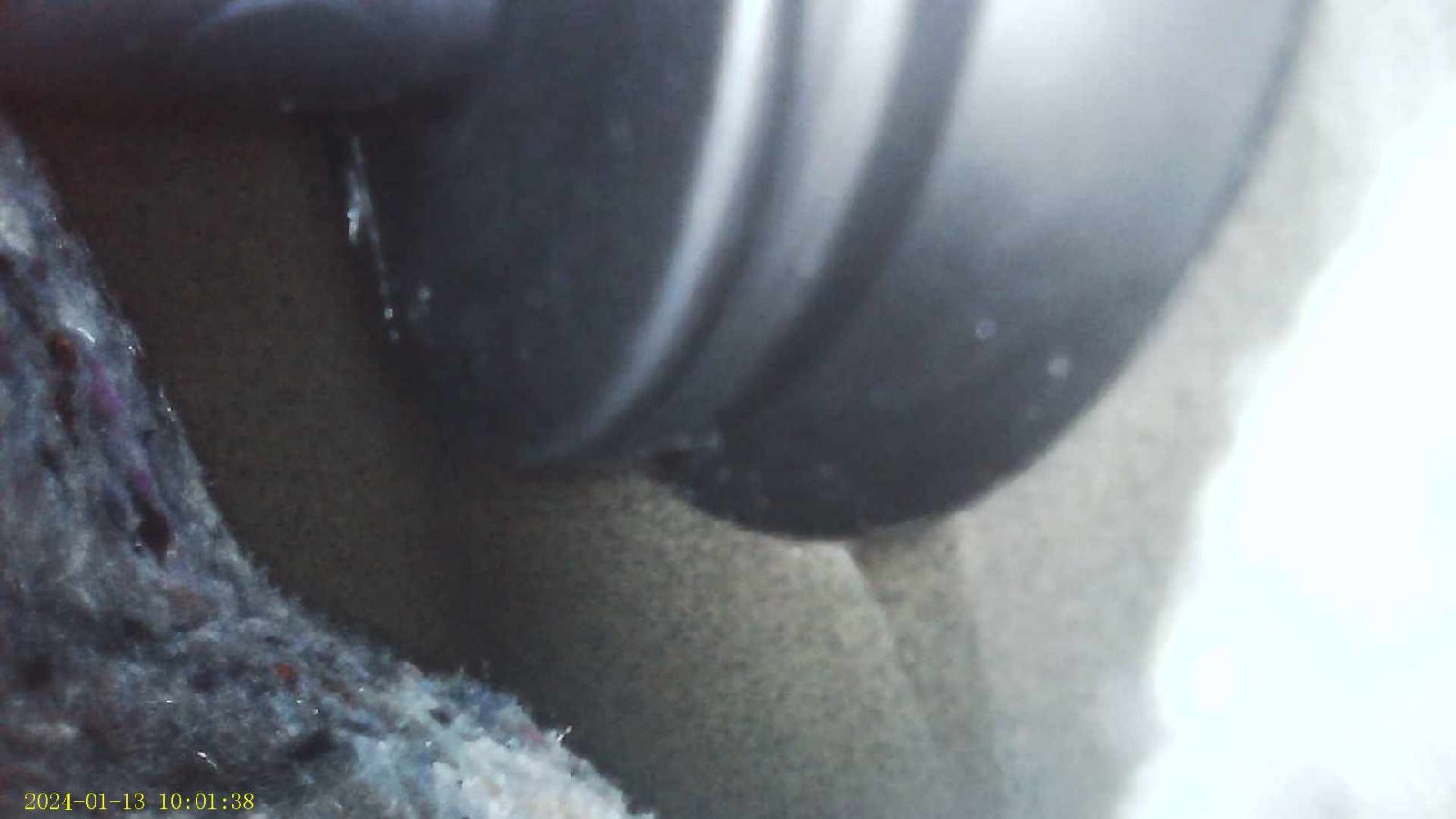

We had some decent rain last night. Parked truck like normal on the driveway with a slight incline (truck facing uphill). I had a hunch it would leak and sure enough there was some water under the carpet again on the passenger footwell. I was able to locate the white sunroof drain hose and followed it to its grommet. There I found evidence of water leaking from beneath the grommet, going behind the insulation and down the firewall to the floor.
I had read on one of these forums that an owner had a leak in this location where the hose met the grommet. That appears to be my issue. Much rather have this problem than the pin holes in the spot welds above the windshield.

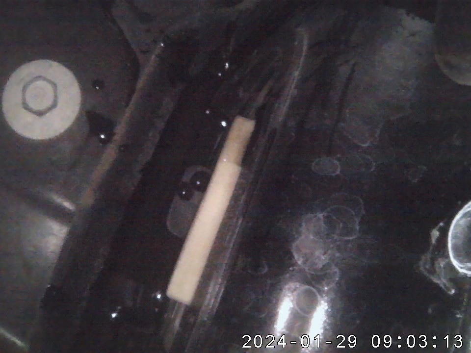

Well, my leak is "fixed." No more water coming down the firewall. I used the same inspection camera to see how the grommet was repaired, expecting to see gobs of rtv silicone around the grommet which I would have been ok with. To my surprise, the sunroof drain grommet (pictured in above post) was completely gone with the hole wide open and the white drain hose was extended with some clear tubing that ran into the right kick panel cavity. It's raining again today so it would be impossible to tell where the water is now coming out (if at all). I will test it in the dry and watch for where it exits the truck. I'm guessing someplace behind the front wheel, coming out from a pinch weld or something.
I was able to locate the end of the hose by using my fingertip as a reference. I popped a grommet near the door hinges and saw my finger on camera. I would have felt better if that hose had actually gone out that grommet and drained to the exterior of the truck (which is outside of the door weatherstripping area). Instead, water is just dumping into the inner body metal which I'm sure will rot things out over time right?
I am pretty sure this is not a GM approved repair. It was completed by a third party water leak specialist. Seems all the dealers in the area use guys like this, albeit different companies.
Someone please advise me here. Willing to escalate this or will take to another dealer. This is my third time in for the repair and they only found it because of my detective work.

I had thought the front sunroof drain hoses drained into the cowling beneath the windshield. This is a picture of the front sunroof drain hose PN 20973104. Unless there is another hose that extends past the grommet (bottom of picture) than it may be dumping into the same place as before, just lower down. I would be ok with that. I'm going to go poking around more with the camera today and confirm 100% if where the original drained to is the same as where it drains now.

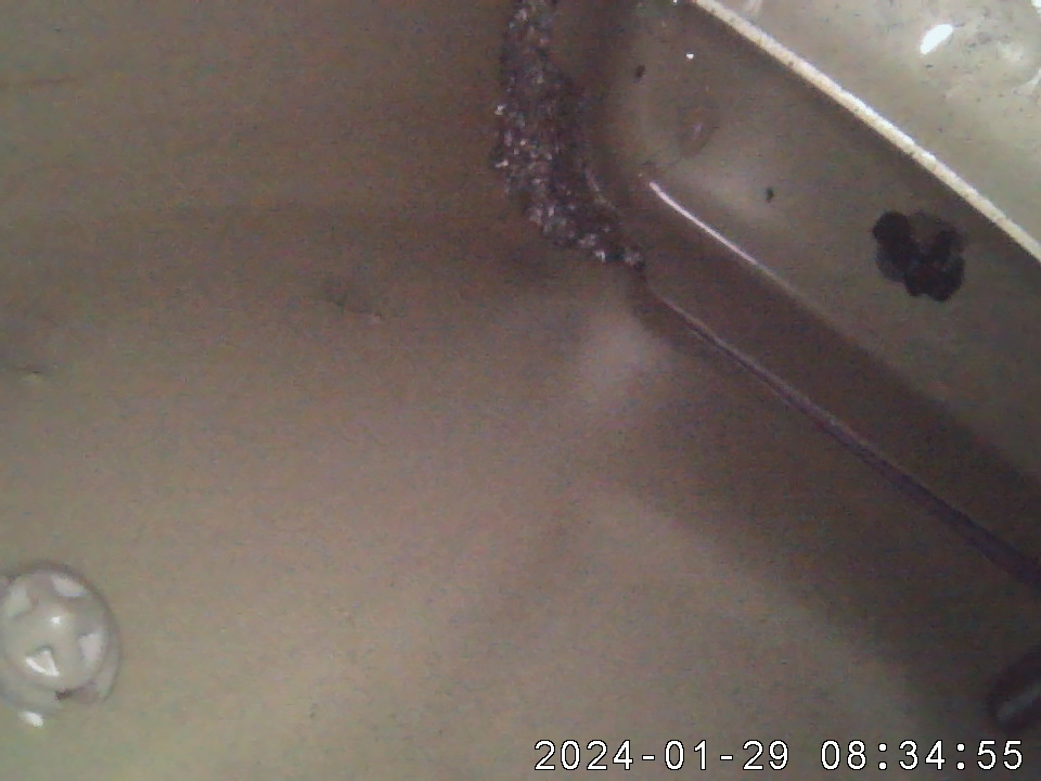

Yes, bad grommet indeed. Just got back inside from probing some more with the inspection camera. I was able to get the camera through the hole of the original grommet location which was very telling. It was clearly the cowling area like I thought.
The new location doesn't seem to have any drain of any sort. The water will just fester there and drain between sections of sheet metal. Not a very good idea IMO.
So, I was able to confirm that the original drain is in a completely different area compared to the current situation. At this point I would be happy with the new clear tube being redirected out of the original hole and goobered up with RTV. If I could more easily get to the clear tube and the original grommet location, I would fix this myself and save myself the hassle.
Camera looking out original grommet hole towards hood hinge bolts inside the cowling area.
Cowling side drain, this is where the TSB 20-NA-219 extension hoses go to.
This is where the sunroof drains now, into a cavity on the backside of the door hinges. This angle is looking up towards the top to see if that's where the original grommet went. There are some holes, but none are round. Two completely different sections. One meant for water draining and the other is not.
Looking to the bottom you can see water collecting.
Water all the way out the bottom with no aparent exit.
