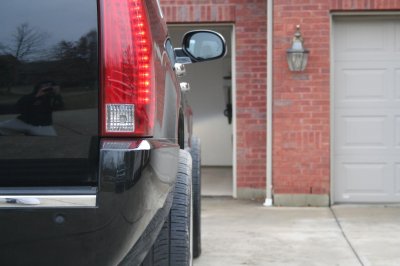

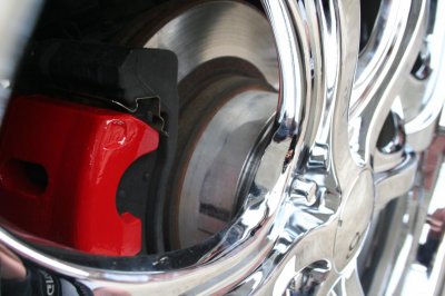

Im about to get the camera and snap some pics... The offset is changed with the spacer. So its more like a spacer AND adapter if thats possible? Ill get pics up ASAP.

so is it not the correct bolt pattern to begin with? From what I understood, the studs don't match up correctly.
I would probably do like the other said and take them off and throw them back up on craigslist. From that pic, they are definitely sticking out too far. The original offset of the rim might be ok, but that 2in spacer/adapter is killing you.
x2, when/if you lower that thing it will cause some pretty bad fender damage IMHO. I would put them on ebay or craigs and be upfront with the guy buying them. I would take it a step further, find out the bolt pattern and advertise them for the vehicles that take that bolt pattern.
IF it were me, I would call the guy and let him know what I thought. I mean YOU did buy them, but now that you understand what type of setup you have, truely that was not a cool thing he did. He offloaded his wheels on you IMO.
They do stick out too far, I personally am not a fan of that. Mine are 1/4in. too far INward and I'm not fan of that either. I like the wheels to flush completely but it's a little difficult of a balance with rubbing etc on the big trucks without some modifications and planning...nothing major but you have to make some adjustments to get it 100%.
