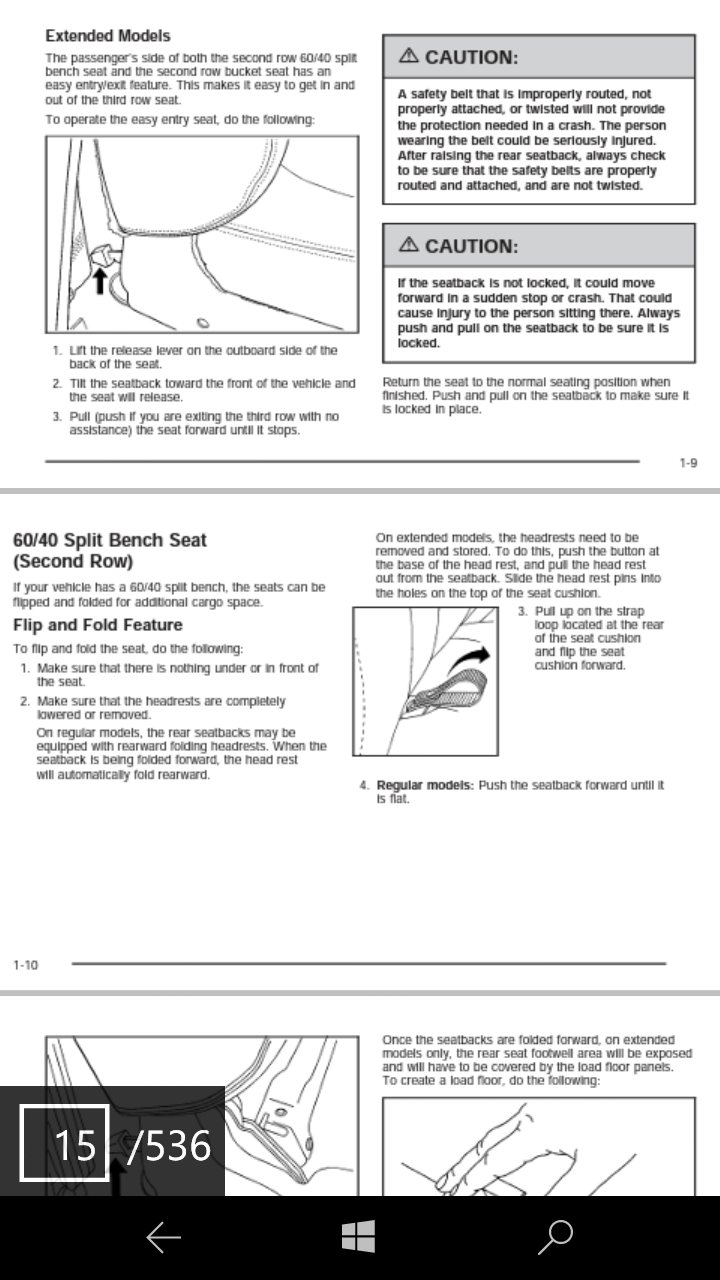

There should be a small lever on the back of the seat near the bottom. See the attached page from the owners manual. Says it is on both bench and bucket seats.wp_ss_20151217_0001.png

There should be a small lever on the back of the seat near the bottom. See the attached page from the owners manual. Says it is on both bench and bucket seats.View attachment 57880
Pic of manual was great,,,but I have no such level on the back. Will just take it in to the Dealer and have them pull up a shop manual. Cables and pulleys(?) everywhere...but nothing does anything.

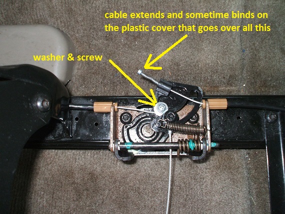

Figured it out!!! Man, is it a complicated mess of cables and cams(?). #1: leave the seat bottom DOWN (there's a cable on it to sense that it IS down). Twist the handle on the side that reclines the seat back B-U-T...tilt it FORWARD. It won't go much as the seat bottom is in the way. THAT pulls on 2 cables joined at a cam pivot point and releases 2 claws that have it locked in a track. It will now slide the entire seat forward for access to the 3rd row. You see...if the seat bottom were folded UP, it would be hitting the back of the front seat and the whole thing couldn't slide forward on the track.
All three cables are joined on 2 plastic pieces. There is a A LOT of stress at that point...HENCE...mine broke.
Since I have the 2nd row buckets - I don't know if the 40/60 seat is even ON a track as the bucket seat is.
The joke at the Dealers Parts Dept is the word "assembly". You can't buy that $2 broken plastic piece. You can only buy the entire rear seat cable/cam "assembly" for $250.
