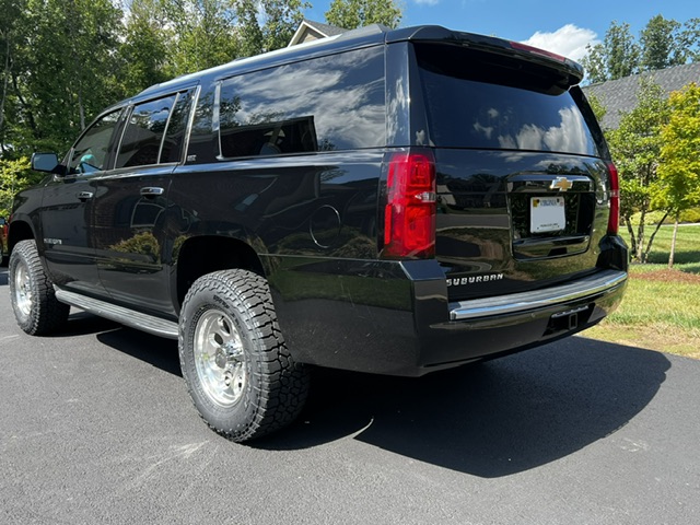

Hello all,
I’ve tried to search the forum but don’t see my exact question discussed.
I recently installed a 3.5” front, 2” rear spacer lift on my 16 LTZ Suburban. I need to do something about the rear shocks and was hoping there was an extender. The only shock spacers I’ve seen require being able to rotate the shock assembly which can’t be done with the magneride. I’m not against doing the delete, just trying to avoid it as the system has been working fine. Am I out of luck?
I appreciate any help!
Rayyy
