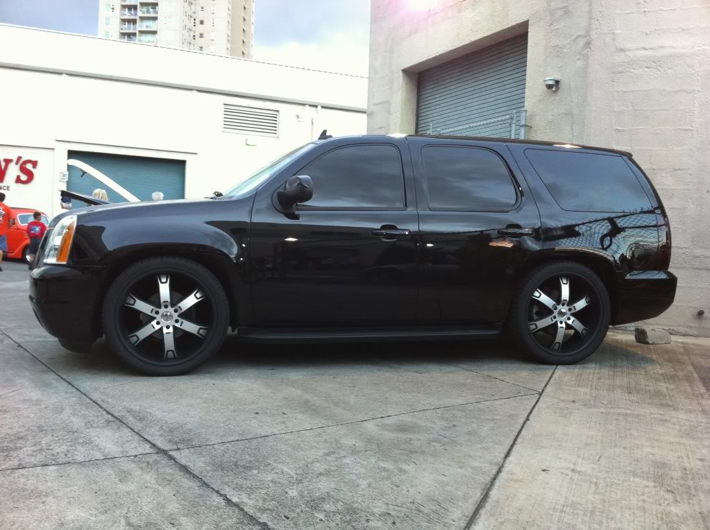

3-5 is definitely doable, clearance issues depend on tire size and wheel offset. I have 24's on 295-35-24 tires and the only rubbing I get is at full turn on the fender liner. I have a 3.5-5.5 drop using the belltech trailblazer rear springs and spindles and a coil re locater up front. I also shortened my ride height sensors and the truck still rides great, and no warning lights have turned on yet.
Jay
heres mines.

^^^^ dam truck looks slammed. Customer just shot this page to me since that's the look he wanted on his ride cept in front doing spindles and machining his struts and xjayx bought the rear set up from me so wants the same look
