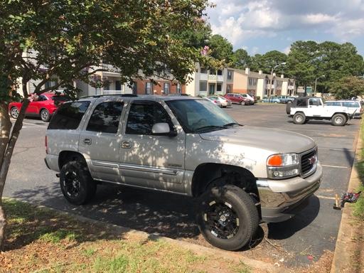

I have a 2002 GMC Yukon Sle. It's rear wheel drive with the torsion bar front suspension. I was wondering if anyone has heard of using lift spindles along with lift keys? I'm trying to achieve about 5 to 6 inches of lift in the front without spending a butt load of money. I do plan on using shock extenders and getting longer brake lines if necessary. I already have the rear figured out. Is using this combination of parts possible? Also, is it safe?
Ok, I know it's been awhile but I have installed the lift spindles in the front and decided not to add the lift keys. I did however pretty much max out the stock keys...still have about one and a half turns left...and this gave me 5 inches of lift over the factory height up front. I also stacked 3 inch and 1 inch coil spacers for the rear. I'm also running 20x9 wheels with a zero offset and 305/55/20 which are basically 33s AT tires with 2 inch wheel spacers on the rear. The lift spindles pushed the front wheels out so I had to compensate in the rear. It did need some minor plastic trimming on the front plastic trim under the bumper and the fender liners due to rubbing.

Did you ever lift with the spindles and keys, I’m thinking about doing the same, I have a 2005 GMC Yukon SLE 2WD
Pics for help, my buddy has a 2002 Chevy and he used spindles just want to make sure
yes, I installed 3 inch lift spindles and just cranked the factory key to almost max..it gave me almost 5 inches of lift in the front
