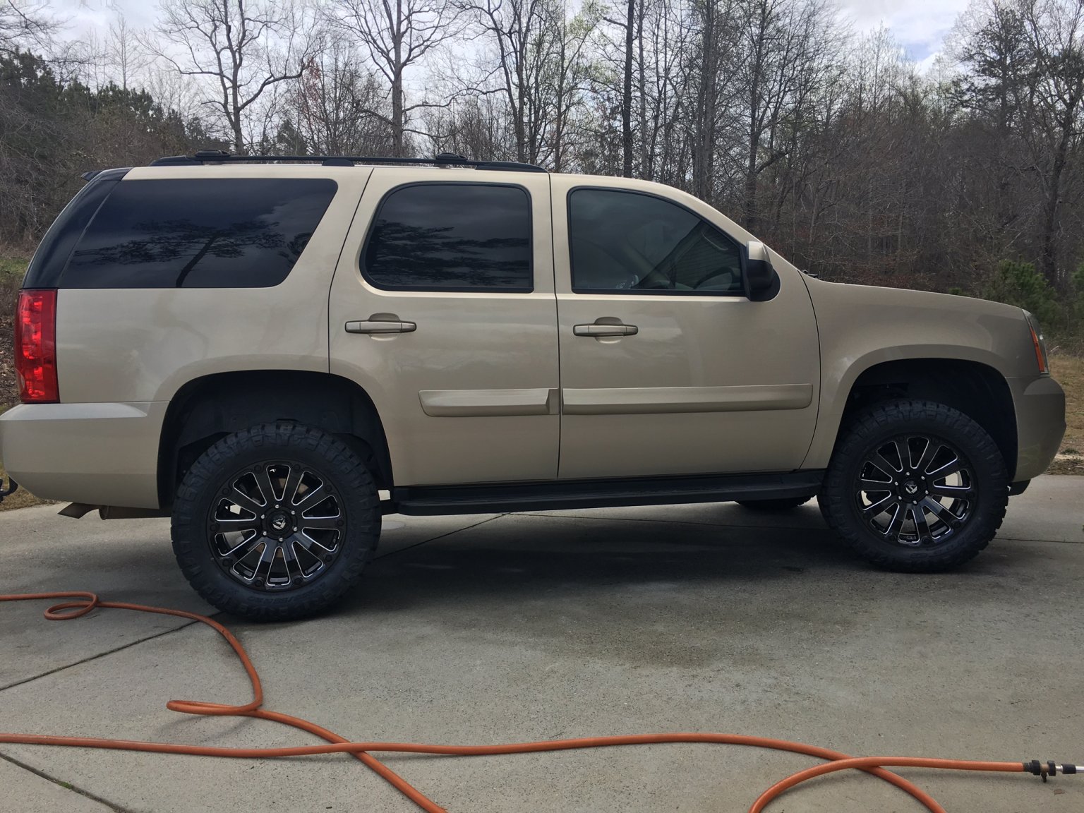

Not sure if I'm too late to add anything or not, but I have a 2010 Tahoe 4x4 LT. I installed a 2.5" leveling kit to the front ONLY. Added some 33x12.50r20 Atturo MT on some 20x9 Snowflakes and they don't scrub at all. Hope this helps someone.View media item 26326
Try uploading again. Really interested in the look here. I've looked at both these tires and wheels.
EDIT: Nevermind, doesn't show on my phone but does on my laptop. Looks terrific!

Small world. I've lived in Cordele for 24 years. Actually just graduated the Police Academy in Tifton last month. I have a few more pics just to give you some pics in better lighting and shows the tire spacing. I just washed her and my back yard is sorta steep, but you can kind of get an idea of what you're looking for.
View media item 26338
View media item 26339

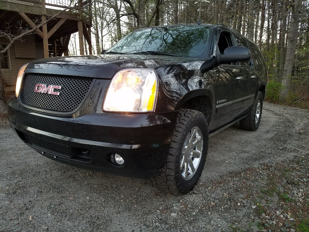

Import, I put a 2" Rough Country level on mine with the stock wheels wrapped with 295/60R20 Nitto Ridge Grapplers. I must say I love the Nitto's aggressive look and they are quiet too. I had to do a little trimming on the inside of the rear liners. I didn't cut the front liner just used a sledge hammer to bend the corner on the firewall a little and used a drimal on the front plastic shelf that the liner attaches to. I was getting on average 16.2 mpg now 14.5-15.5. I did put a K&N CAI on it and it got me about 1 MPG when I could keep my foot out of it. It sounds great when you romp on that 6.2. Anyways I hope this helps have a great day.
View attachment 78705 View attachment 78708 View attachment 78709
