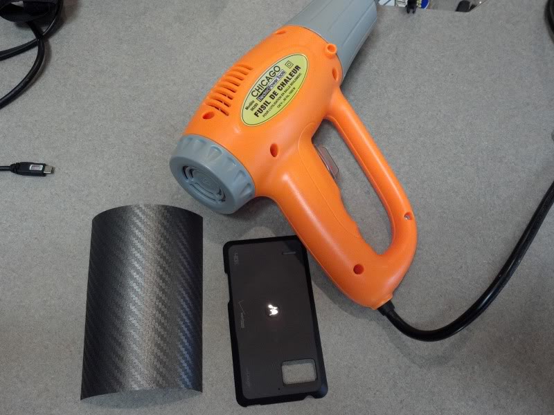

Just did a quick test on my cell phone. Here are a couple of pics. Things that I learned.
1. Precut but cut the dinoc a little bigger than what you want to cover, maybe a half inch or so because it shrinks so much when you heat it.
2. Have extremely sharp brand new razors. If they're the slightest bit dull it will mess up what your doing. the dinoc will be kind of squishy/pliable, so if you cut it while it's warm it's like cutting pudding.
3. take your time and squeegee as much air out as you can.
tools
the template but i cut it way to close. i would cut it out after i've heated it onto the surface.
the end result. a couple of air pockets and i creased the dinoc a couple of places trying to rush, but it's super moldable when it's hot, so take your time heat slowly and squeegee.
