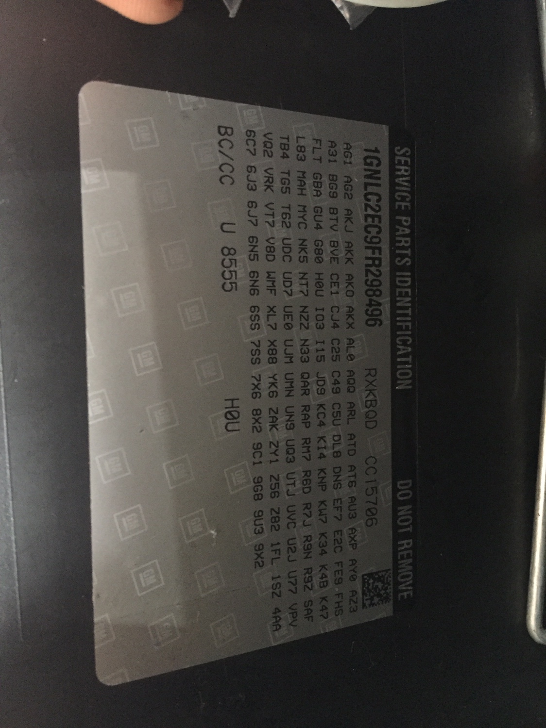

Hey guys, new to the forum. I saw this as my first thread and wanted to add a little something to it. I bought my wife a 2015 Tahoe, but it came with everything but a 8" screen(weird i03). I contacted MVI and they supplied me with everything needed to do the install. Took me about two hours to do so, and that included soldering everything and making it look factory. I have my own Jeep Srt8 that I do my own work on, but could not deal with that little $hitty screen. It does everything that the factory would have supplied. The harnesses they make are super clean. The YouTube video makes it easy as well. I took pictures for them so that they could use them for other people that are not as skilled to help understand.
My wife uses BT and streams music. I opted not to get the NAV because the iphone does the trick. I regret not getting the upgrade so I can mirror my phone onto the 8" screen. MVI had shipped me all the necessary parts, but somewhere in shipping the screen had gotten a broken tab. They were quick to send me a replacement. Good guys a very responsive, via TEXT ONLY. The calls took a day or two to get back to me, but it was nothing every technical.

I have the full video. they email it to you when you purchase their kit. It is a very easy install. I know it's a little too late, but for the guys that currently have it, or may end up purchasing one will now know they have the option. I could barely see what wires they tied into, so that is why I took pictures. The video does a good enough job to get you through it. I took pictures of each harness and what wire to solder into.
