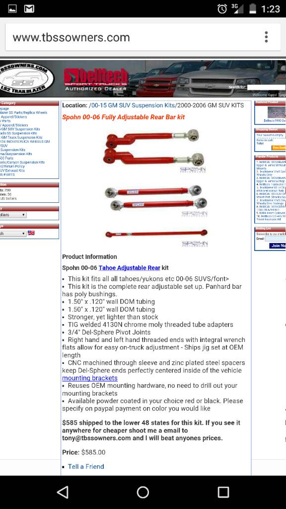

I know the panhard bar helps with the handling. Why do you specifically recommend it in this case?

The adjustable Panhard gets the rear back to center left and right after lowering the truck since the stock one will push the rear end to one side
Usually don't need it on a 2/3 drop but in the case of a 3/5-4/6 it will really shift to one side and cause issues

in rear 4-6 id get bar. You can see how the pass side tire sticks out more and i posted a pic of a customers truck in my vendor section showing this
