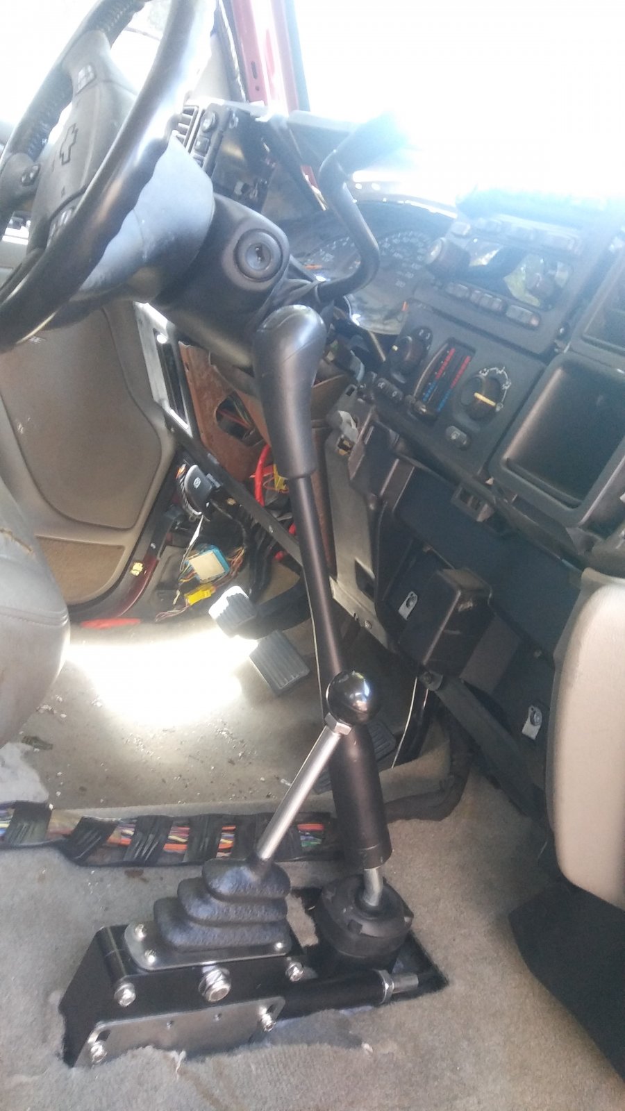

Welp got an update, been dallying this thing and lately it has gotten hard to get it into 1st gear from a stop, and second gear has resistance when taking it out of gear when I am about to shift to third, no problem rev matching/downshifting back to second, I woke in the wrong side of bed and noticed my clutch pedal felt spongy, could be me day dreaming but I felt it once and once only, ever since that event "if it indeed happened" the 1st 2nd gear thing has been happening. Checked fluid full, but dark af, so I plan on parking it and do a bleed and fluid exchange, see if that improves, if not I might swap the master cyl, as I suspect it could be the issue, if that doesn't fix it then maybe I did bone a shift rail or something, will update later.
