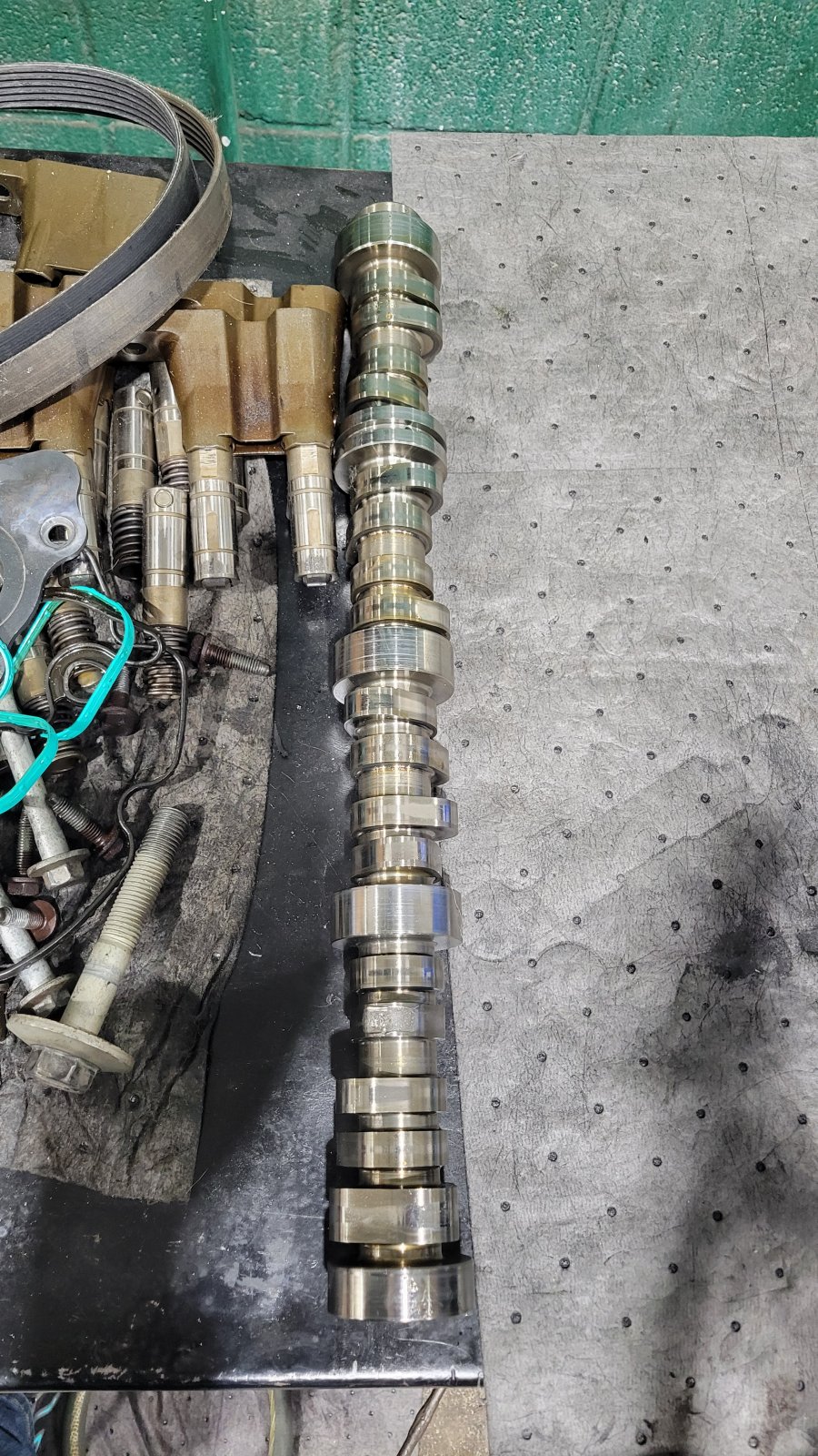

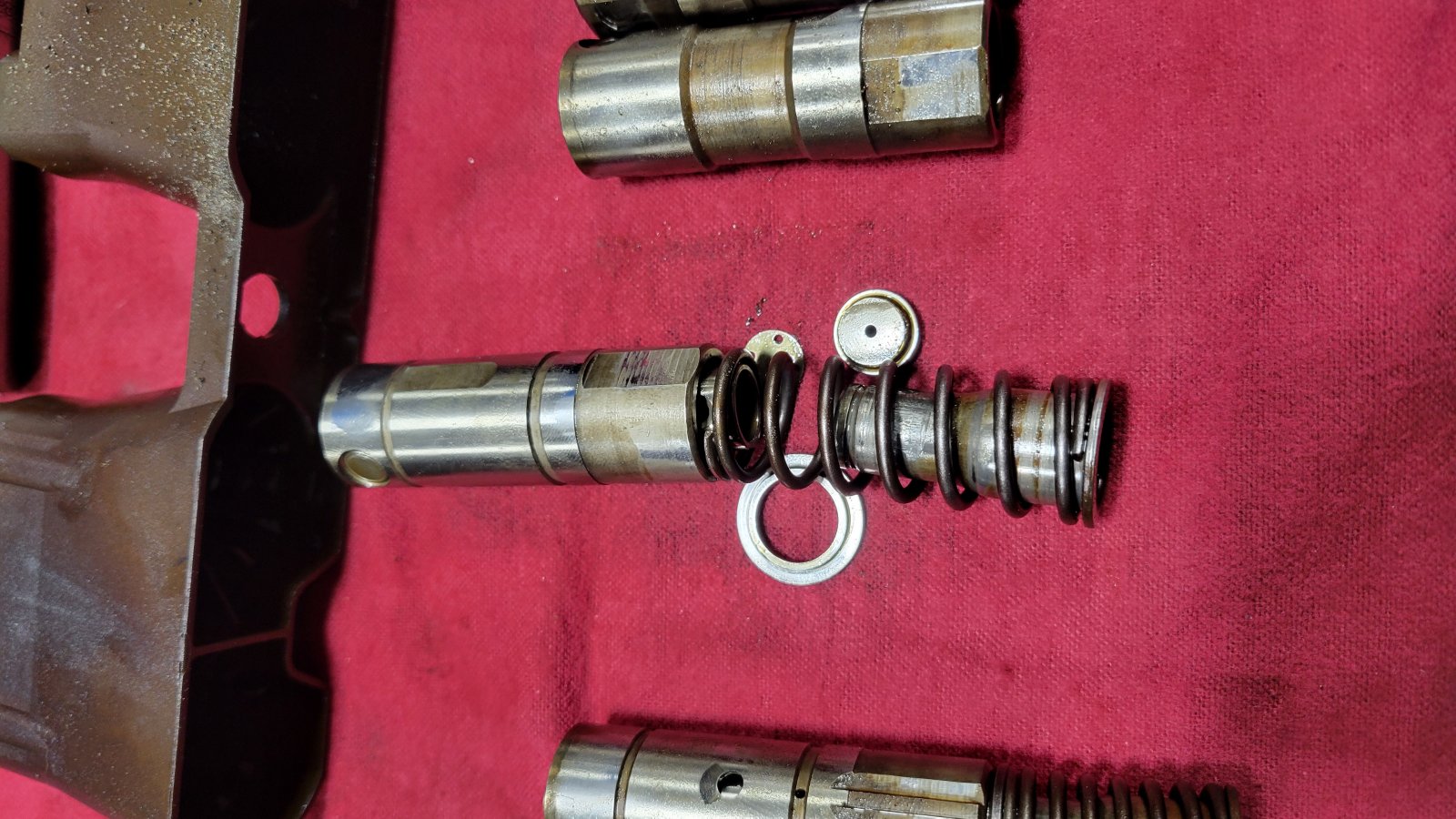

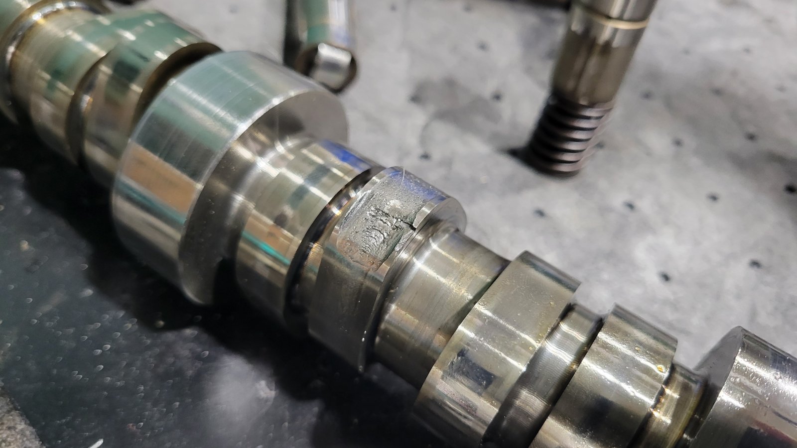

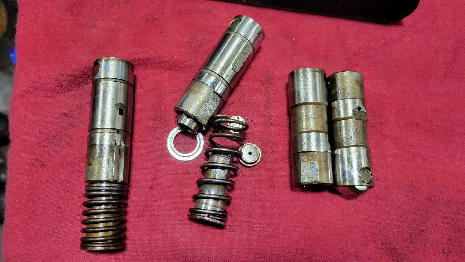

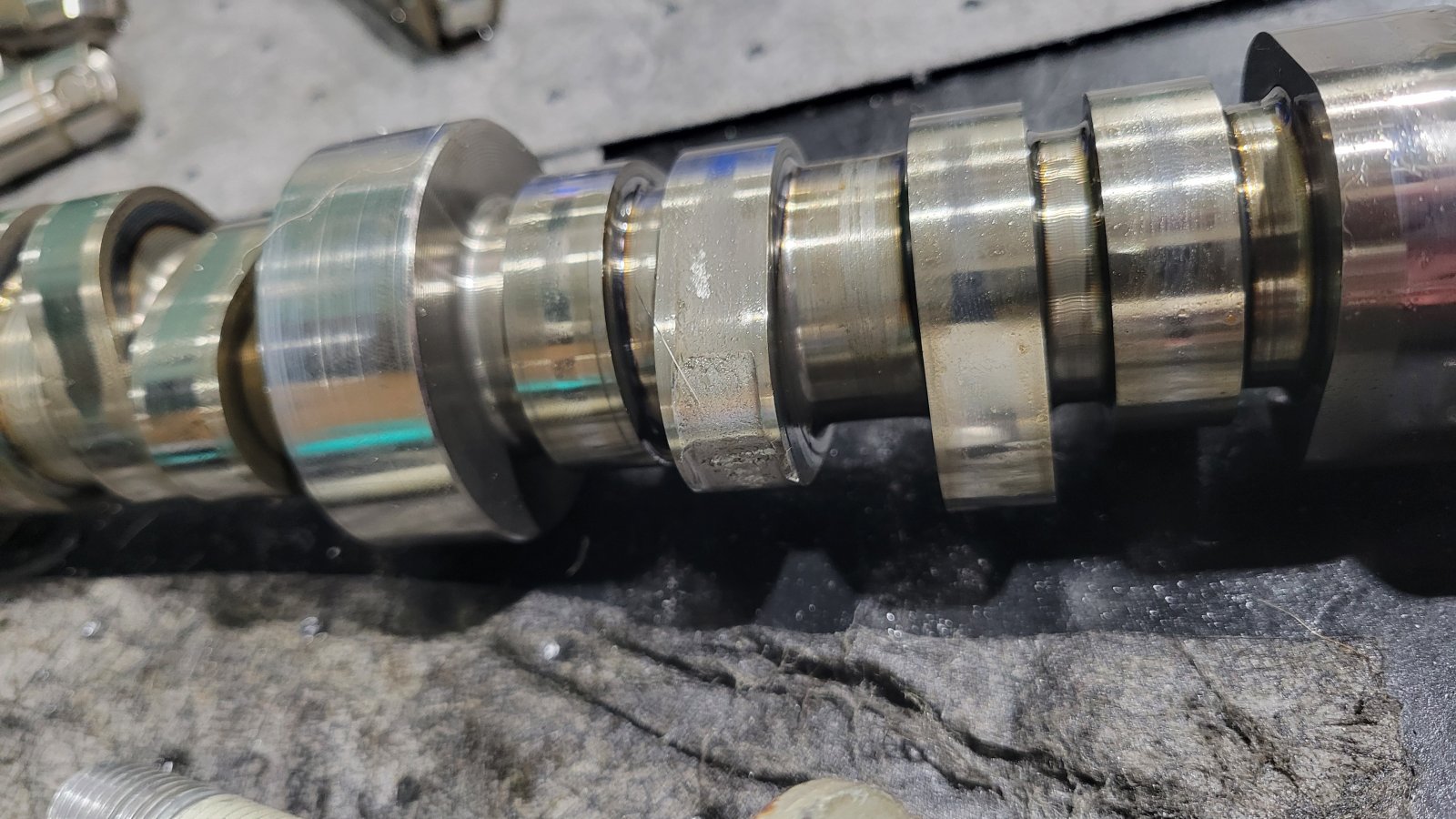

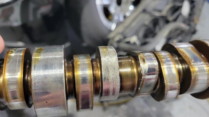

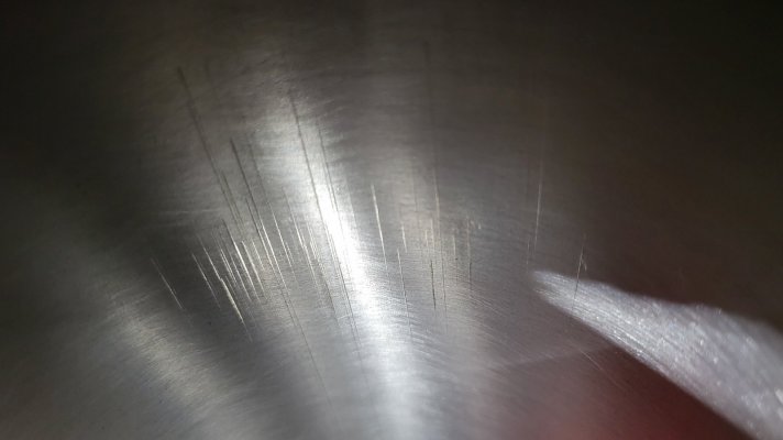

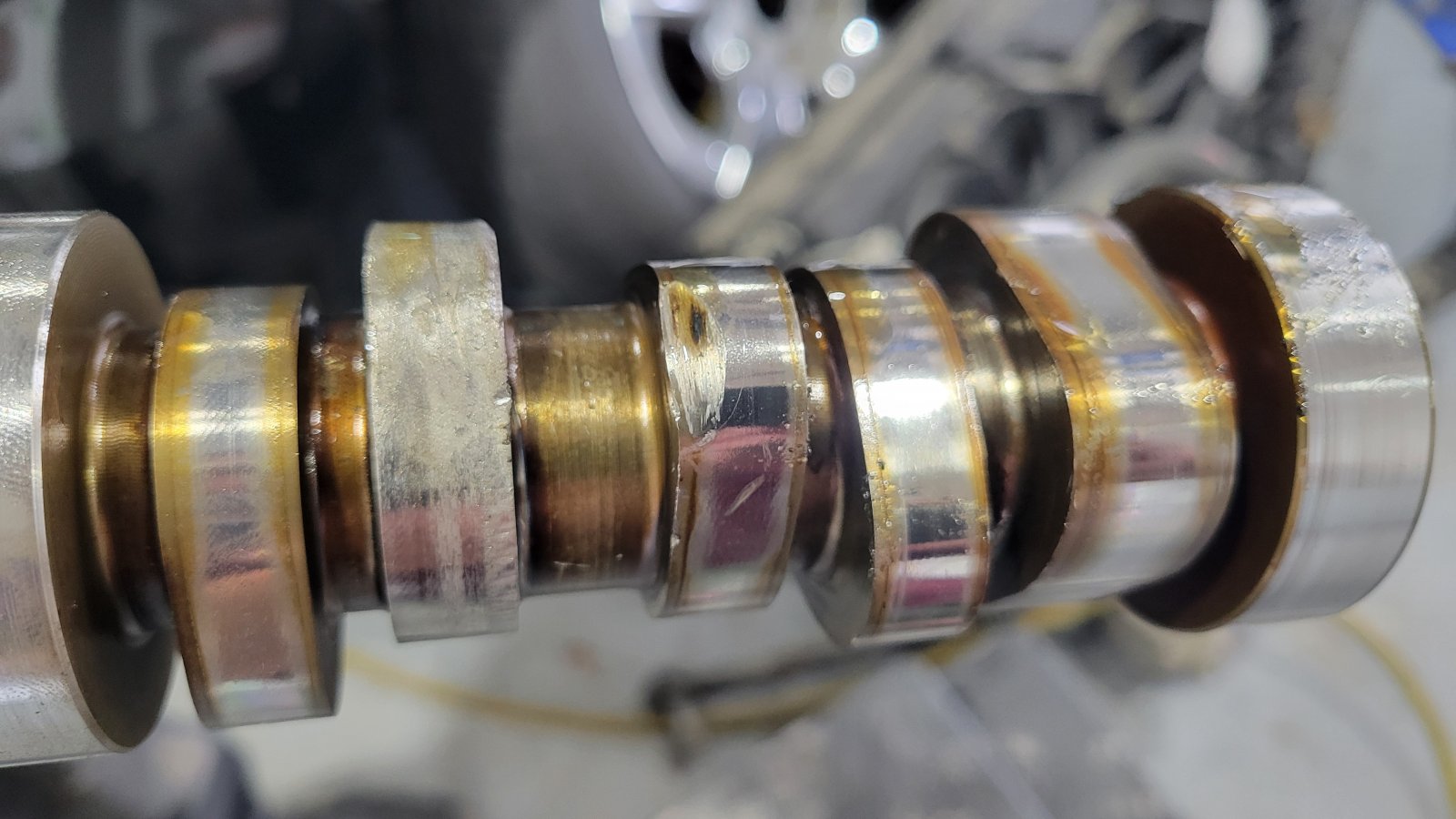

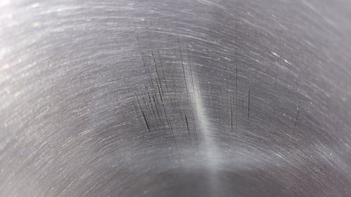

2019 GMC Sierra Denali 6.2 with 67,359 miles. I seem to have lost the pictures of the offending lifter, however here is the result of the camshaft. This failure may have been actually caused by the camshaft having a metallurgy issue. Just look at the casting, it looks porous or soft?

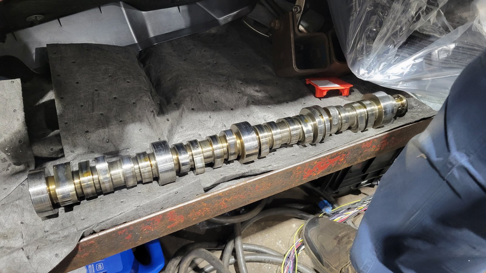

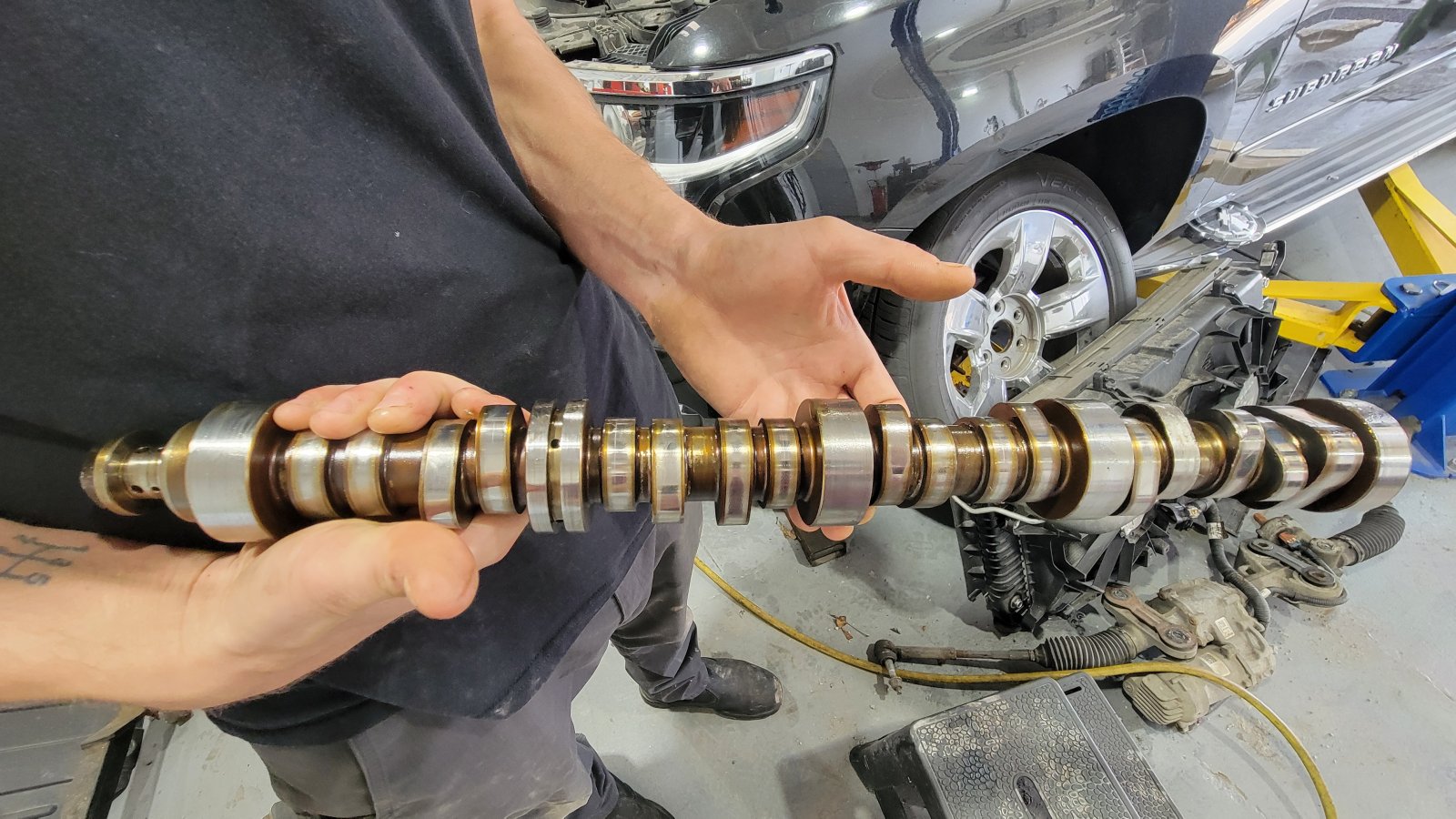

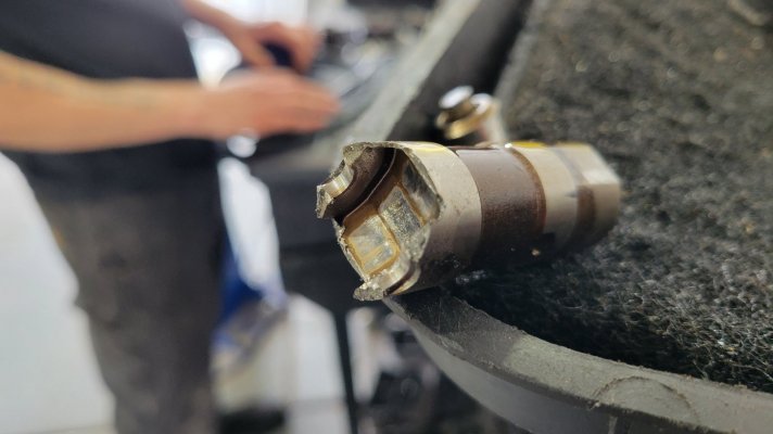

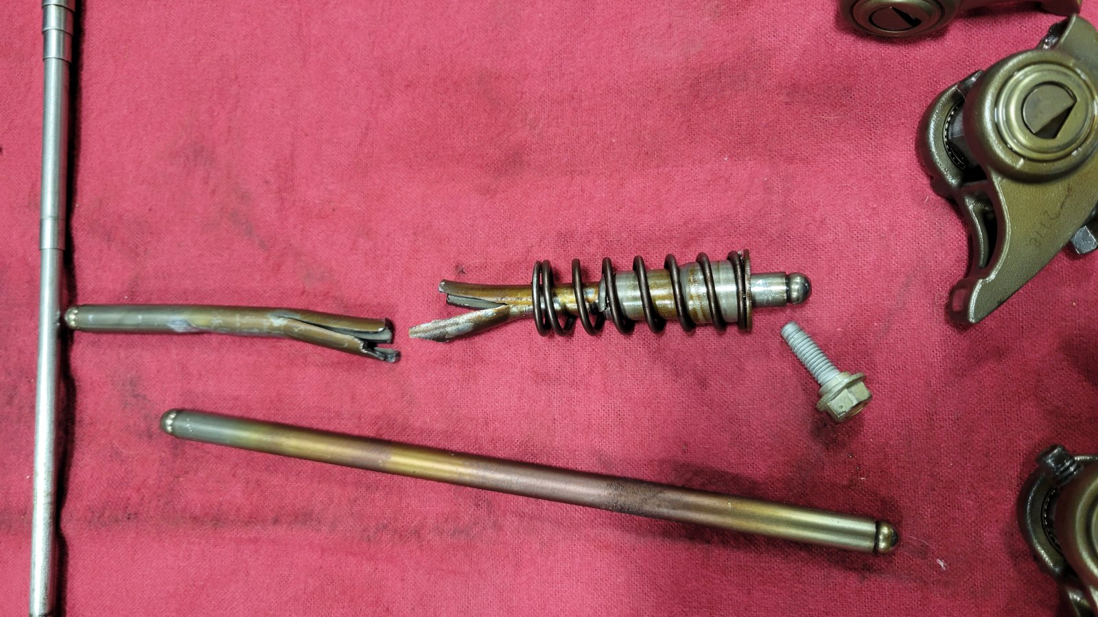

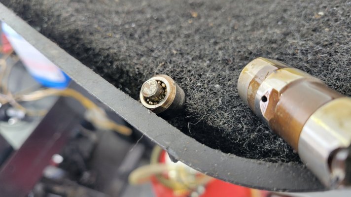

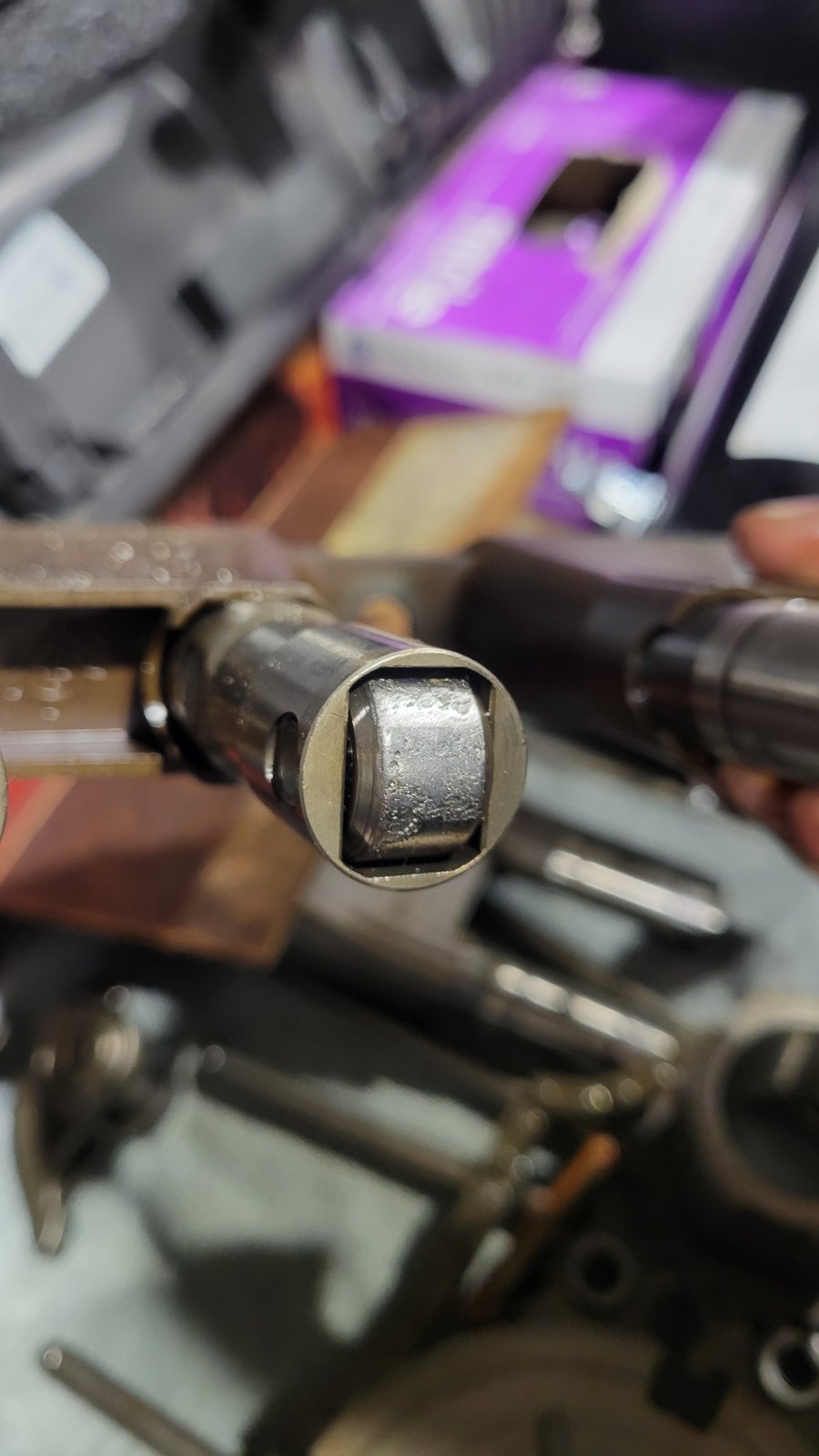

2018 Chevrolet Silverado LT Z71 5.3 with 81,444 miles. The camshaft in this one was OK, as you can see the lifter came apart and "imploded" the push rod.
