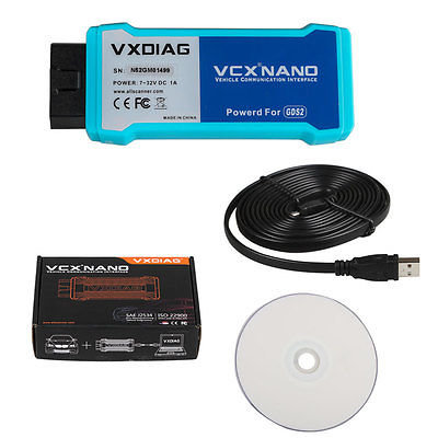

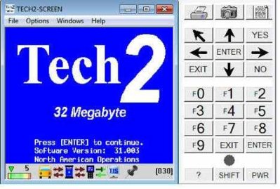

While on the subject, where does one find a proper tech 2? I've poked at it but can only seem to find clones or $2k units. Is there an inbetween where I could get a legit unit at a price reasonable to the home DIYer?
