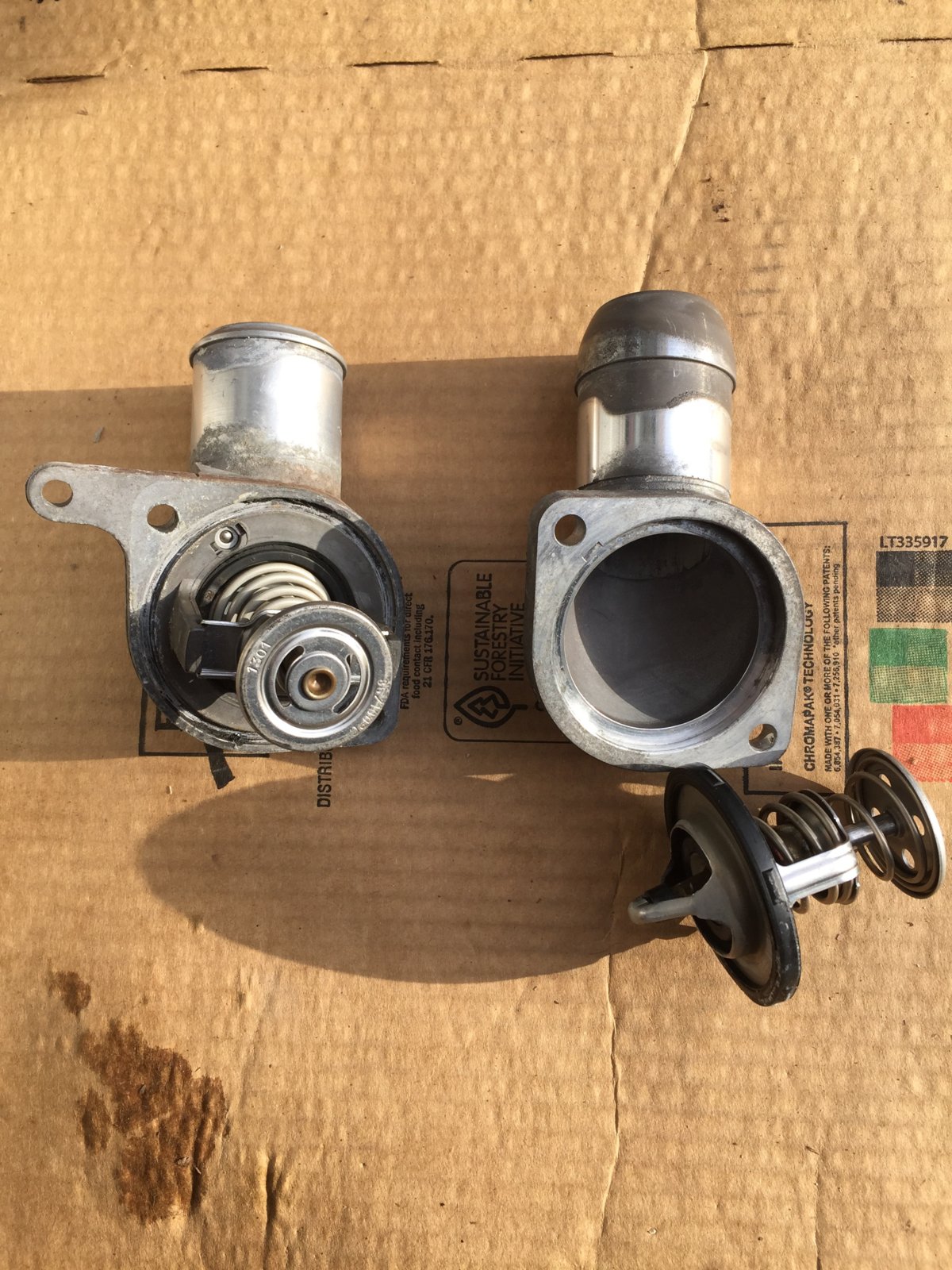

Well got the pump switched out today. Thought Id post a pic of what I found inside. Thermostat and housing from my 6.0 on right, and on the left for comparison a one piece unit from a 5.3 pump I replaced couple months ago

Don't know about your '05 but on my '04 there were different water pumps used. Depends on the pump casting number. Two sizes of housing openings. 1.88" and 2.01"
Not sure that info is very helpful ...
EDIT: In Canada.
