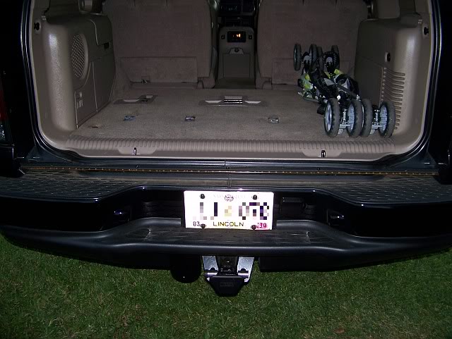

I finally installed the lightbar thats been sitting in the garage for almost 8 months. These fit better on the OBS, but I made it work with no problems. I pulled the factory trailer hook-up from the back, plugged in a 7-pin to 4-pin adapter and ran it all behind the bumper for a cleaner look. I made a plate to fill the hole left back there with an old license plate and painted it black. I see these all the time on pick-up trucks, but not too many on hoes & yuks. When the rear hatch is closed and the lights are off, you don't even know its there.

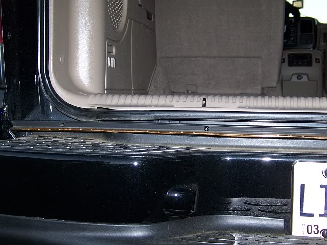

As you can see, it hangs over on the ends because of the shape of the rear hatch, but its secured with 3 screws in the center.

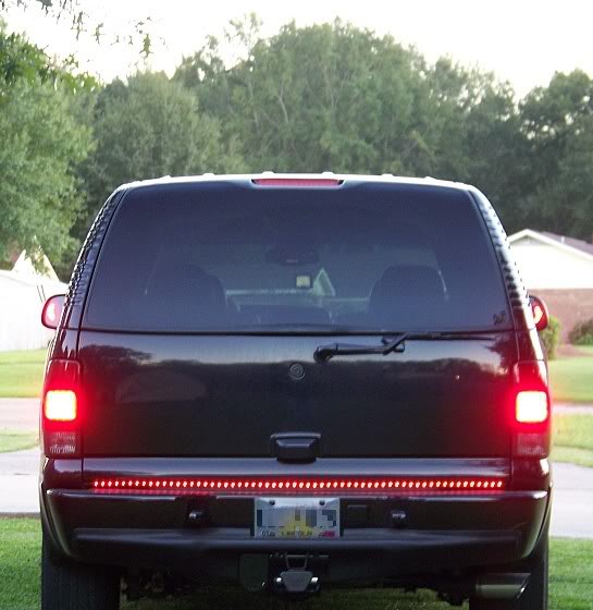

When the brake lights are on, 99 LEDs are shining bright (tails, 3rd brake light & lightbar)

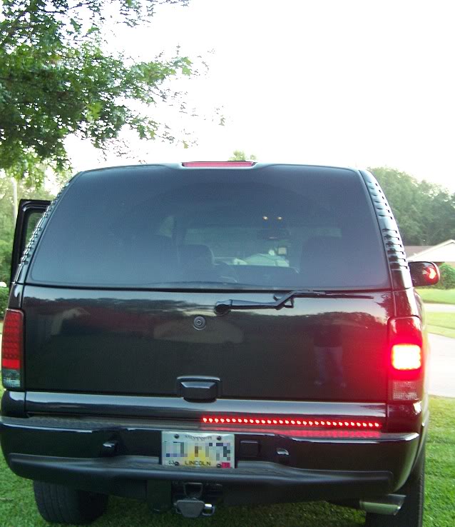

Turn signal...49 LEDs total
And this is with the hazards on
