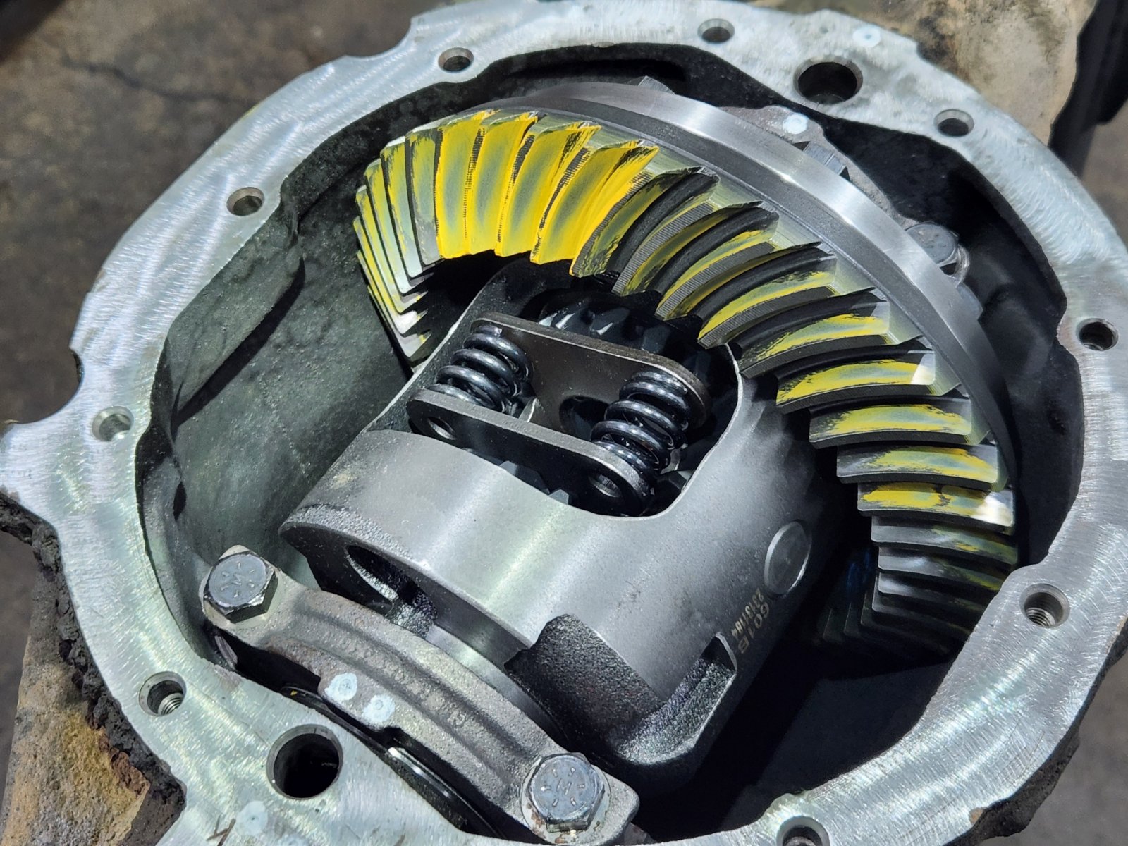

Does your Camaro have a 10 or 12 bolt rear end that your new posi unit is going into?
Axle upgrades, too?
MrMonte
MrMonte
Jun 23, 2022
233
598
Axle upgrades, too?
It's a 10 bolt rear using a posi made for a 90s GM truck with a 30 spline 10 bolt then I'm upgrading the axles. Installing 12 bolt 30 spline axles made for a 1970 SS big block that came with a 12 bolt rear.
I did this same setup when we built my Son's 74 Camaro with a 600hp 454. Makes a very strong but not too heavy rear.
